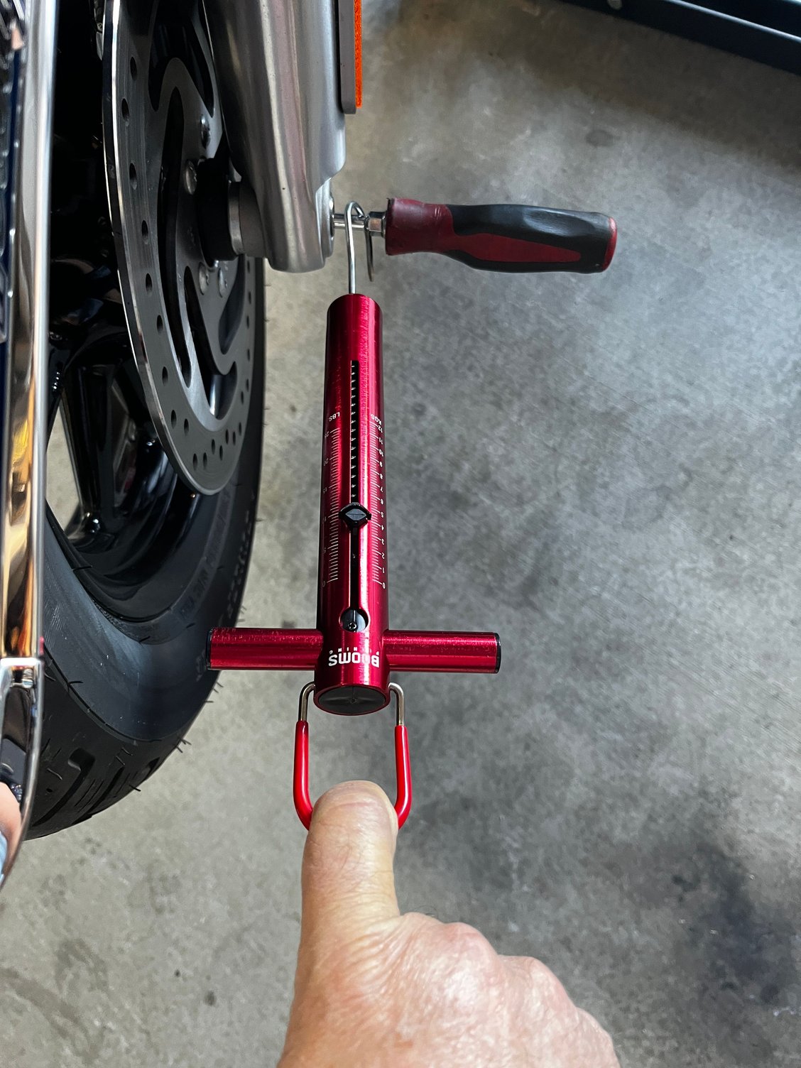

I'd think a fishing or suitcase scale would work fine. You can buy them for well under $10.

I use a fish scale. Works fine.

Wallyworld, Amazon, a fishing and hunting store near you should have the scale or one like it as shown in the pic. You see the little black dot on the scale number, that stays in place when you release the scale.

This is what I have. I don't fish either, so I bought this and it worked great.

That's a fair price for a scale like that.
You can check it's accuracy with an item of know weight (fishing weights are not what they claim, not sure about common weight lifting weights?). Or get a 1 gallon water jug, if it was filled correctly, it will be about an ounce or so over 8 pounds (due to the container it should be over 8#).
