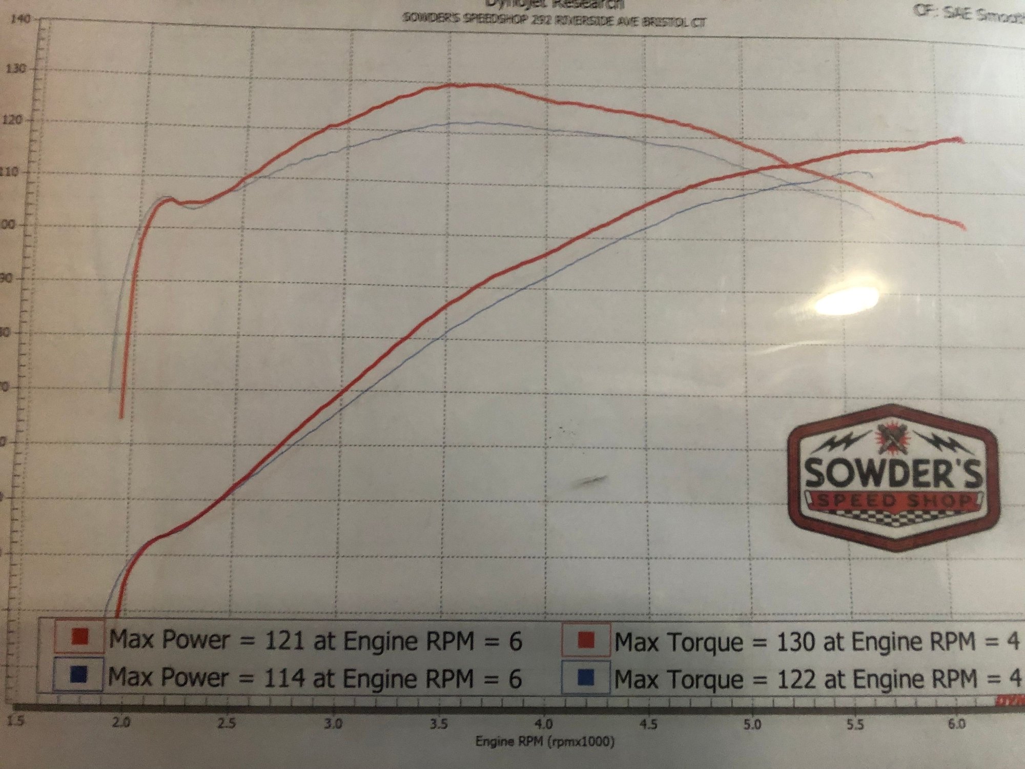

Well here is what got my brain juices flowing, after moving down here to Louisiana where it’s real flat, the weather is much nicer and gas quality is much better for cheaper than Washington. I got smoked real bad by a Street Glide ST by a rider that’s much bigger and wider that me on a heavier bike. I figured there was a 200lbs difference between the two of us and I just couldn’t real him in, after a gas station chat up he told me how he set his set up.
So I was pretty set on the 22XE or the XD, after digging around looking a cams all over again the 508 stick has more duration so I was looking to cheat it up a little bit in the meantime to help it on the bottom end with the 114, I’m also considering a bigbore kit in the future and they eat duration like candy so I was figuring it wouldn’t hurt when that time came along either.
This is what planted the seed in my pea brain and I wanted a general idea from a reliable sounding board.
