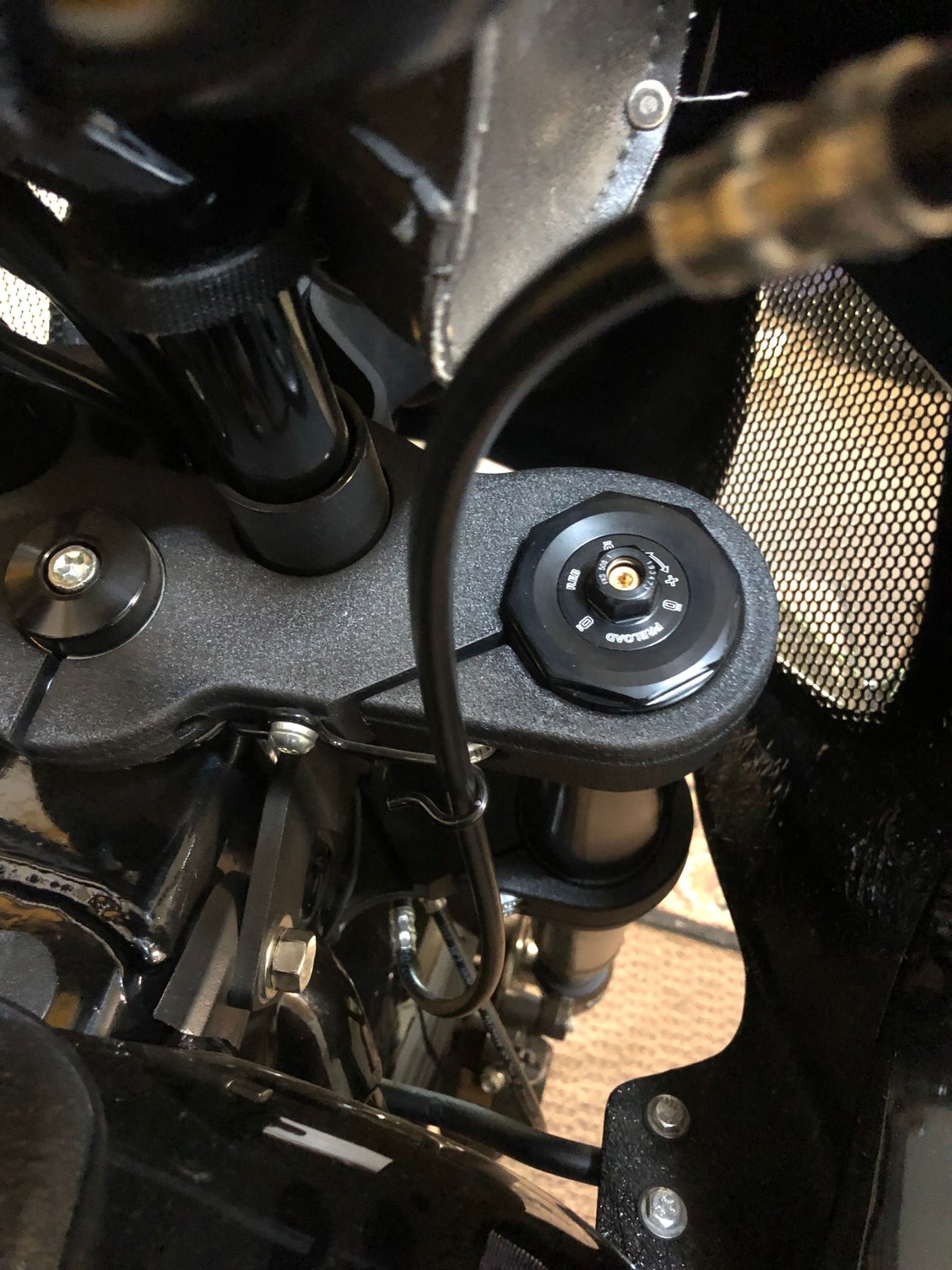

External adjuster to fine tune makes Olin’s worth every penny in my book. Harley inverted forks have the same guts as the regular forks.

@Durham man Are you running shims to get the tubes all the way down in the trees or an aftermarket top triple tree?
