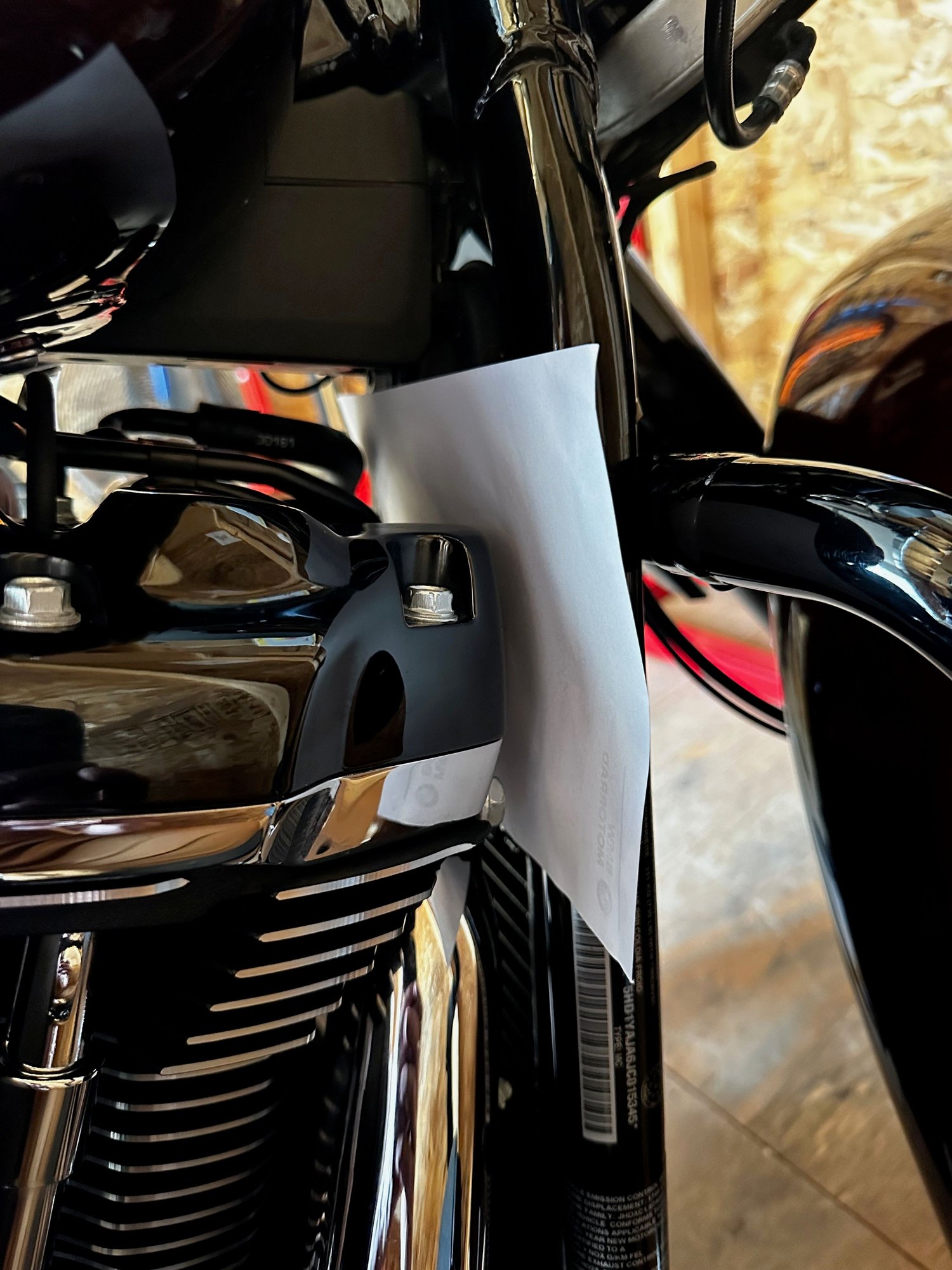

2018 HC 107. Always thought this bike vibrated too much, but never having a "B" motor before I didn't question it thinking it was the nature of the beast.

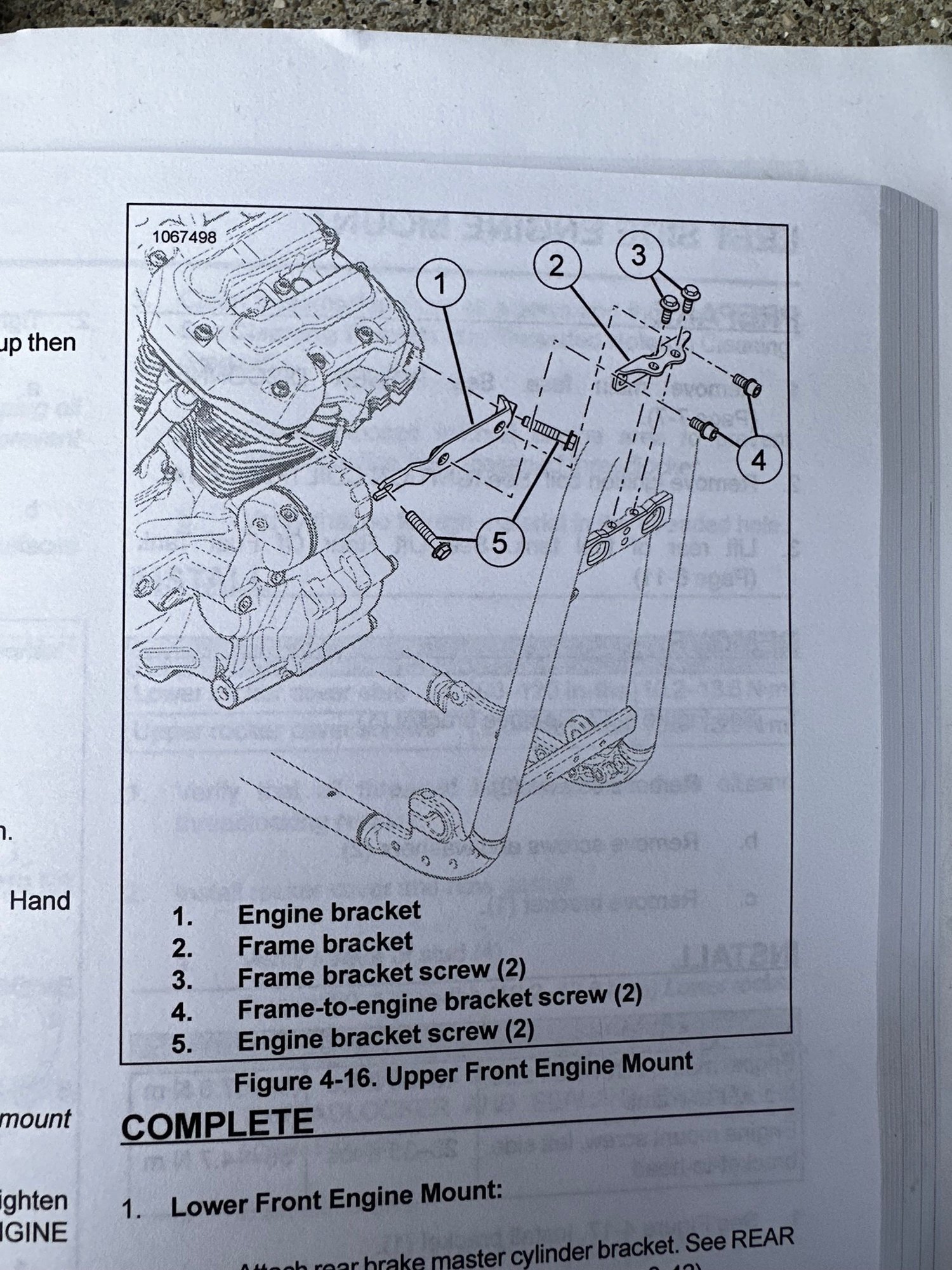

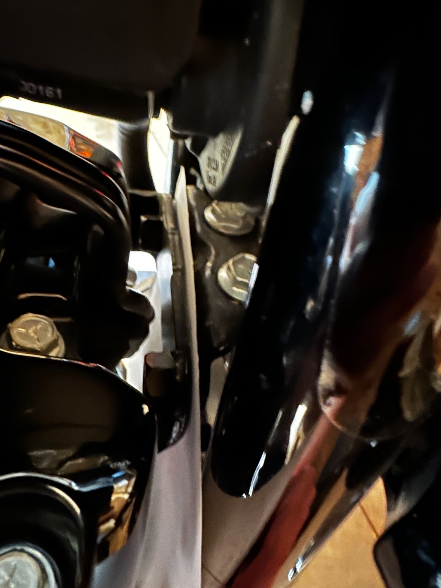

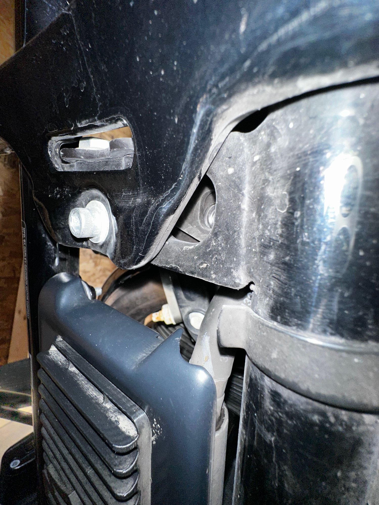

Turns out the two bolts (Item# 4) in diagram are missing, these bolts attach the motor bracket to the frame bracket. I slipped a sheet of paper between them to help you see it better. Called my local dealer, to explain and they asked for photos. They are ordering the bolts and told me to drop by when they're in and they will happily install them for me.... Makes you wonder what the mechanic looked at when the first service was done (previous owner and the owners manual has the dealer stamp saying the first service was done).
Item #4 missing 2x
showing missing bolt
top view with paper sheet between brackets
side view with paper between brackets

Hard to capture with a photo but when you look at the bracket and receiving nuts on the motor bracket the paint hasn’t been disturbed or rubbed off. Makes me think the bolts were never there.

The allen head bolts with washers came in and I installed them. There is a reduction in vibration, but the buzz in the handgrips is still an annoyance for me, to others probably insignificant, but for me and my Raynaud's disease its a curse.
