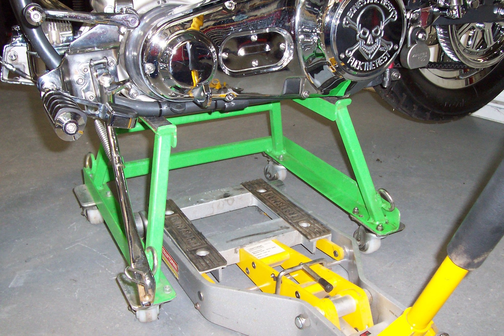

Silly children, use a lift to get it up, sit the bike on a dolly then it doesn't make on rats f**k what brand lift you have and it's as or more stable than a table lift and nowhere near as much garage used up.
How did you get the bike onto the dollie??
Jim G
Pretty simple... Never rely on a jack alone to work on one don't care what brand it is.
Ok, I see now. You have a lift that fits entirely inside the dolly, lift the bike first, slide the dolly in from the opposite side, and then remove the lift. It's a LITTLE more time and effort, but not bad! And if the dolly does NOT have wheels, or has lockable wheels, it can be much steadier and more stable than when on a lift.
Thanks for pointing this out, TwiZted Biker.
Jim G
Jim G
5 minutes, all it takes to get it on or off the dolly. You want good wheels, you'll want to move the bike around or leave it up at some point. Doesn't get any more stable, strapped down you can get real physical, pull the frontend, wheels, whatever
That would even be practical for doing a full bike wash. Doesn't matter if you get water on the dolly. Easy to dry it off given its small and simple shape.
And at ;east in theory, you could make that dolly any custom width that you want, varying the width to either enable easier access to the bike or to make it more stable against moving when you use high torque on nuts or bolts. As long as it clears the lift, no problem.
Thanks for broadening my tunnel vision.
Jim G
