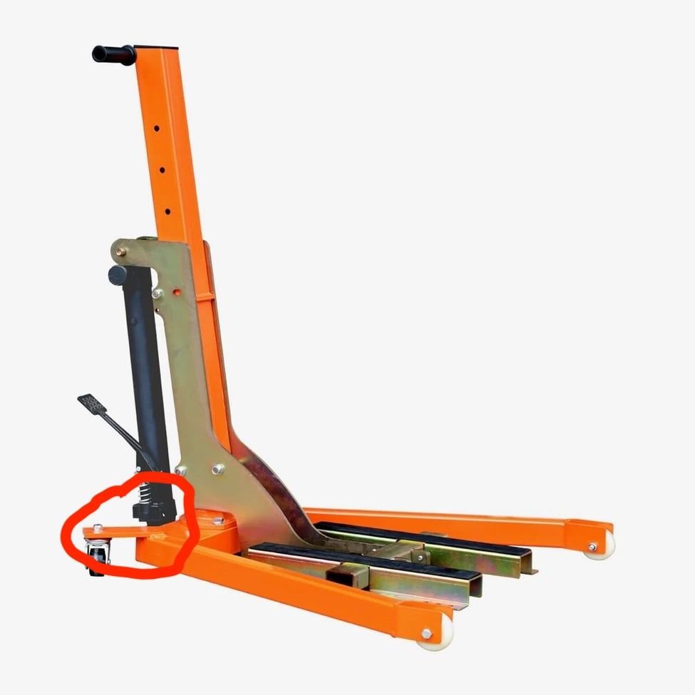

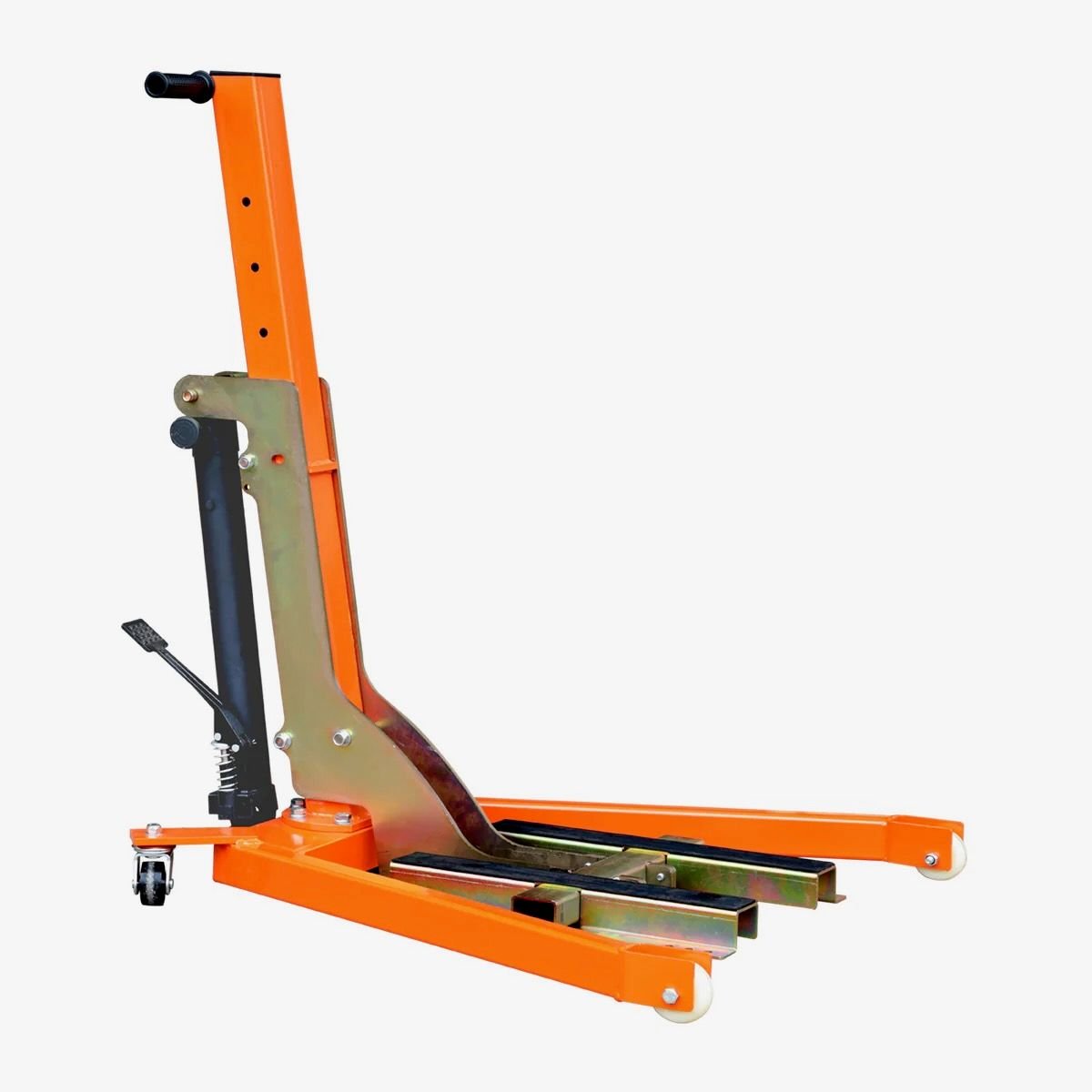

The more I look at it, the less I like it. I personally would not buy it, based on some concerns I have. Bear in mind, I've never laid eyes on one, or used one.
This is totally unsupported and unbraced, and I think it's going to allow for a lot of sway of your bike.
The arms that go under the frame of your bike appear totally loose on the cross arm, and will probably rock side to side, letting your bike tip back and forth.

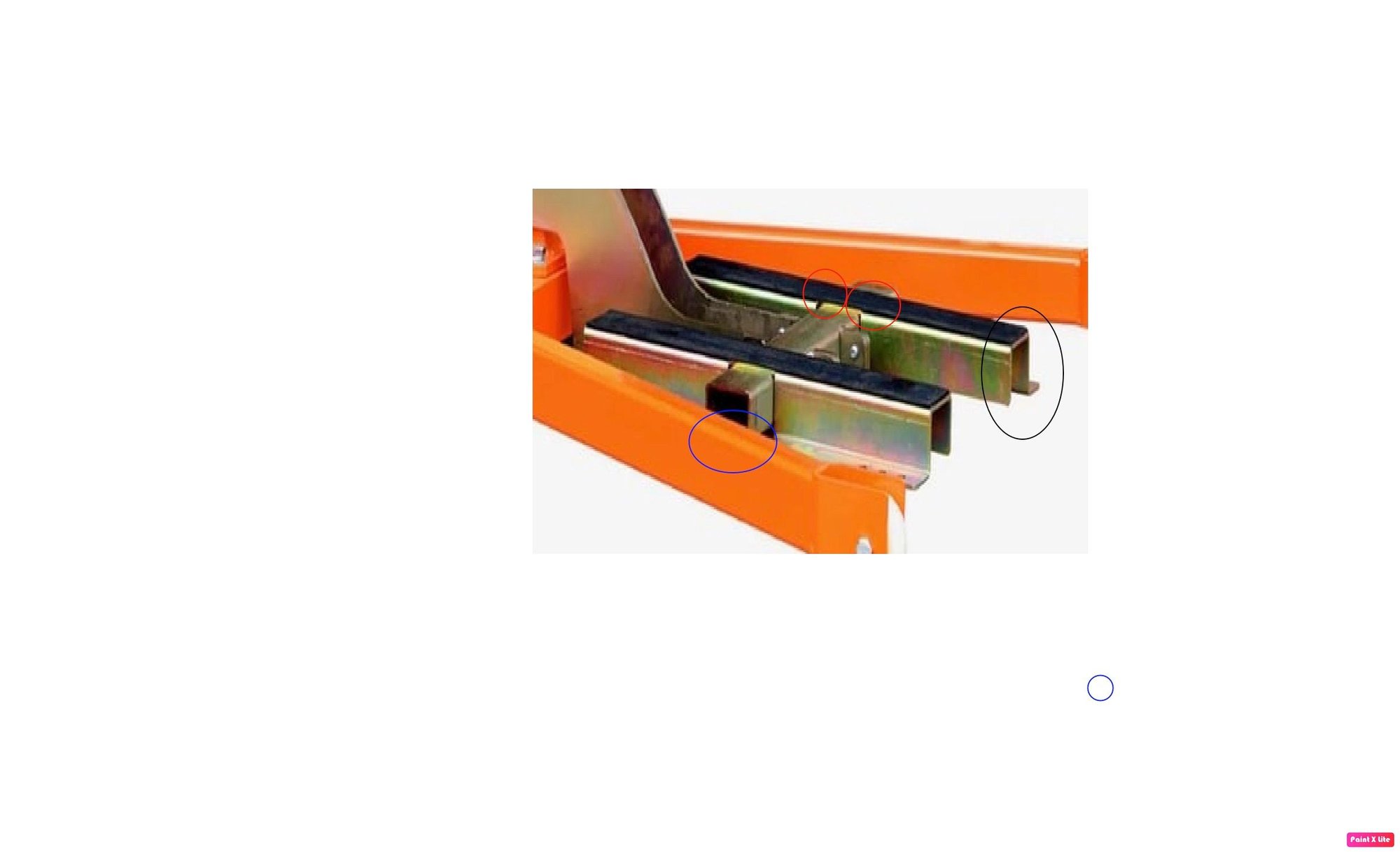

There is some very dubious structural integrity with regards to the arms that go under your bike. I strongly suspect they will sag, if not downright buckle and collapse under the weight of a heavy bike.
Look at the black circle. It shows these arms have only one flange. The other side has none, and in the manual (which I cannot download now), it shows the arm is completely notched through on the unflanged side.
So there are two hinge points on that arm, circled in red
There is only one piece of flat steel resisting that hinging, and that's the single flange on the outer side, circled in blue. It's completely unsupported and will easily buckle.
My opinion of the poor rear wheel mounts, which I pointed out previously, has not improved.
