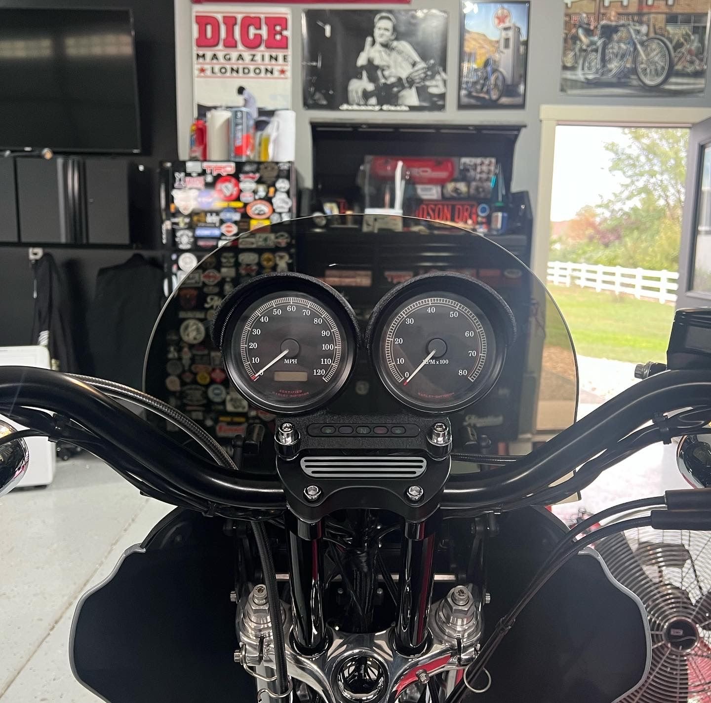

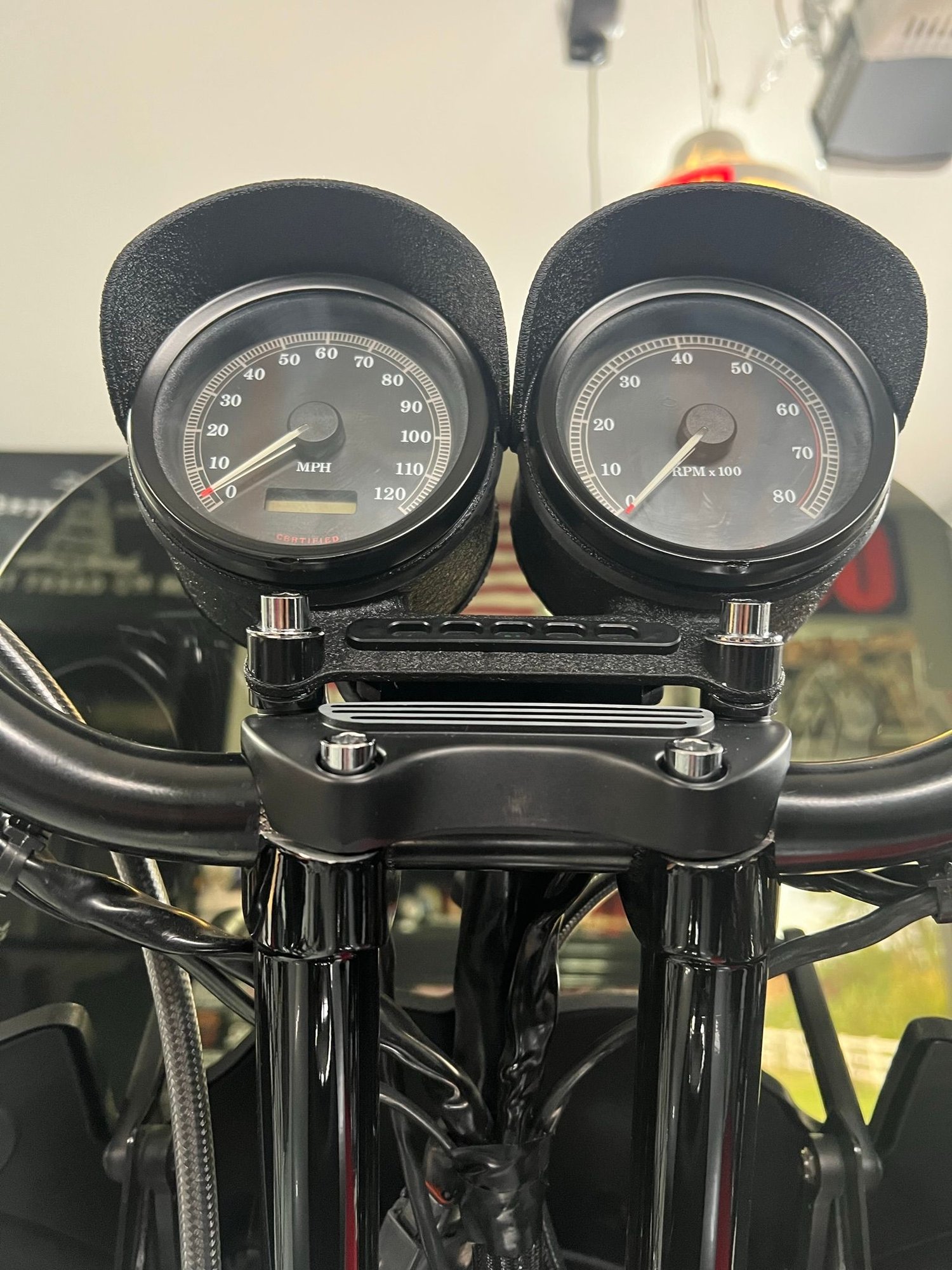

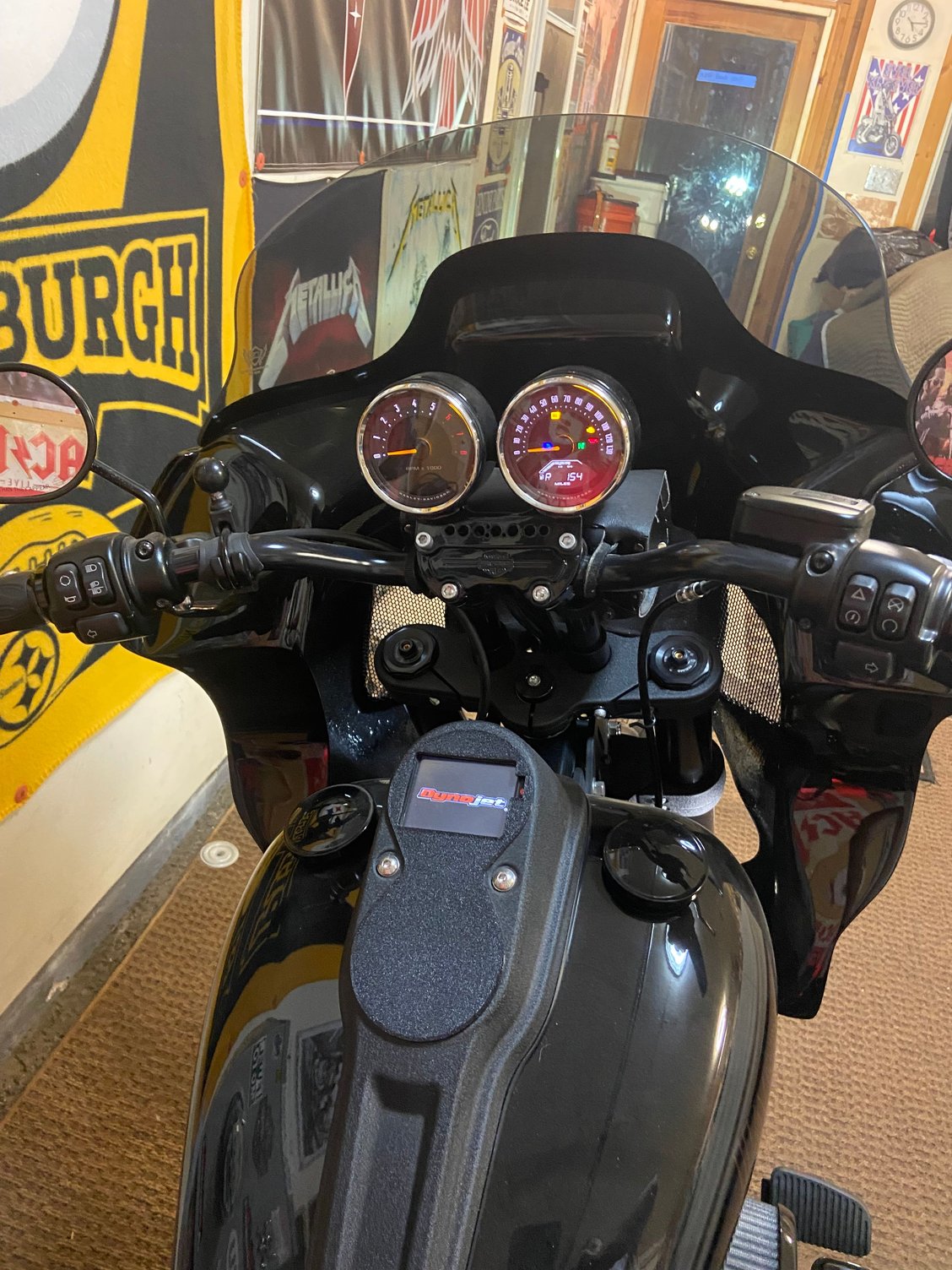

Duel analog.
Old Aug 9, 2024 | 10:36 AM
vizcarmb's Avatar
vizcarmb
Joined: Mar 2011
Posts: 3,482
Likes: 632
From: NorCal Rocklin

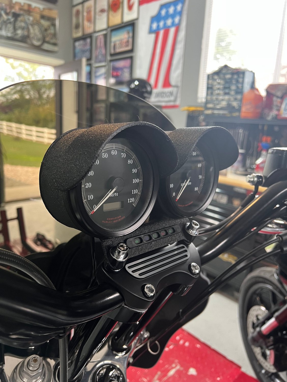

Here is a screenshot of said visor

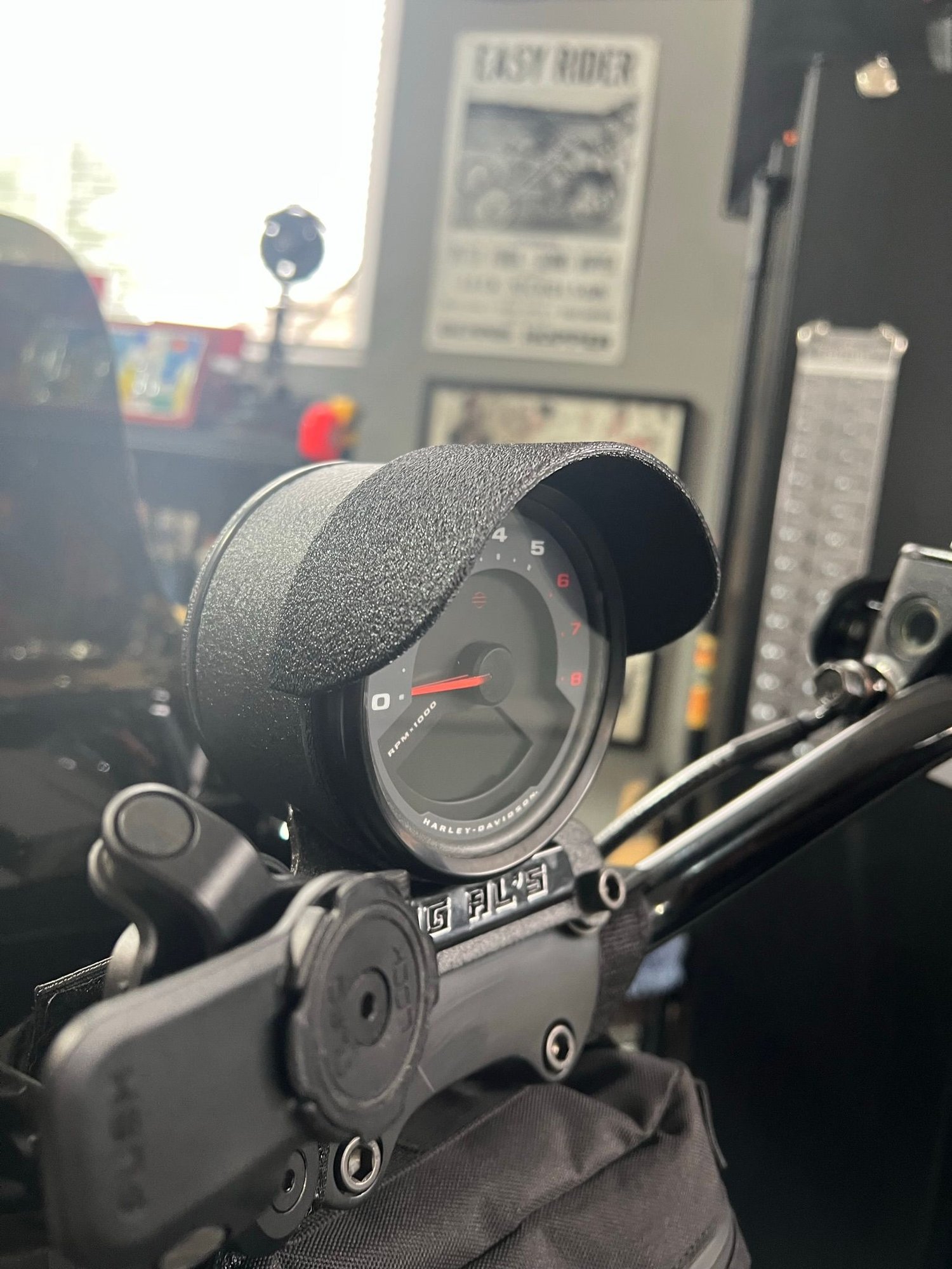

Anyone find a visor for the single round gauge? FXR’s used to have em but not sure where to even find those anymore.

I believe going from single analog to duel and vise Versa is just getting the right pig tail. To go from the st digitali to analog you can call fxr division in airizona.He will advise.

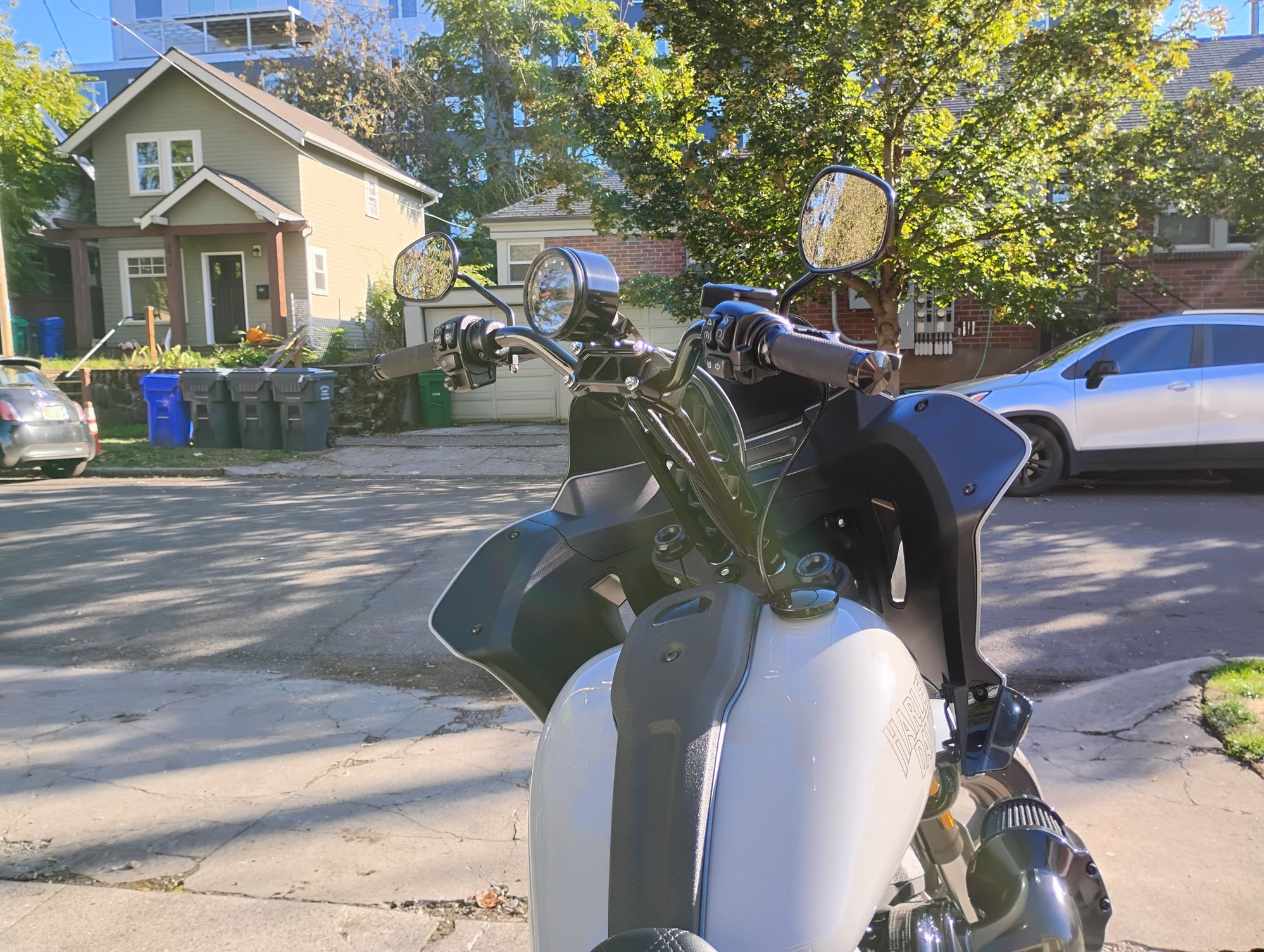

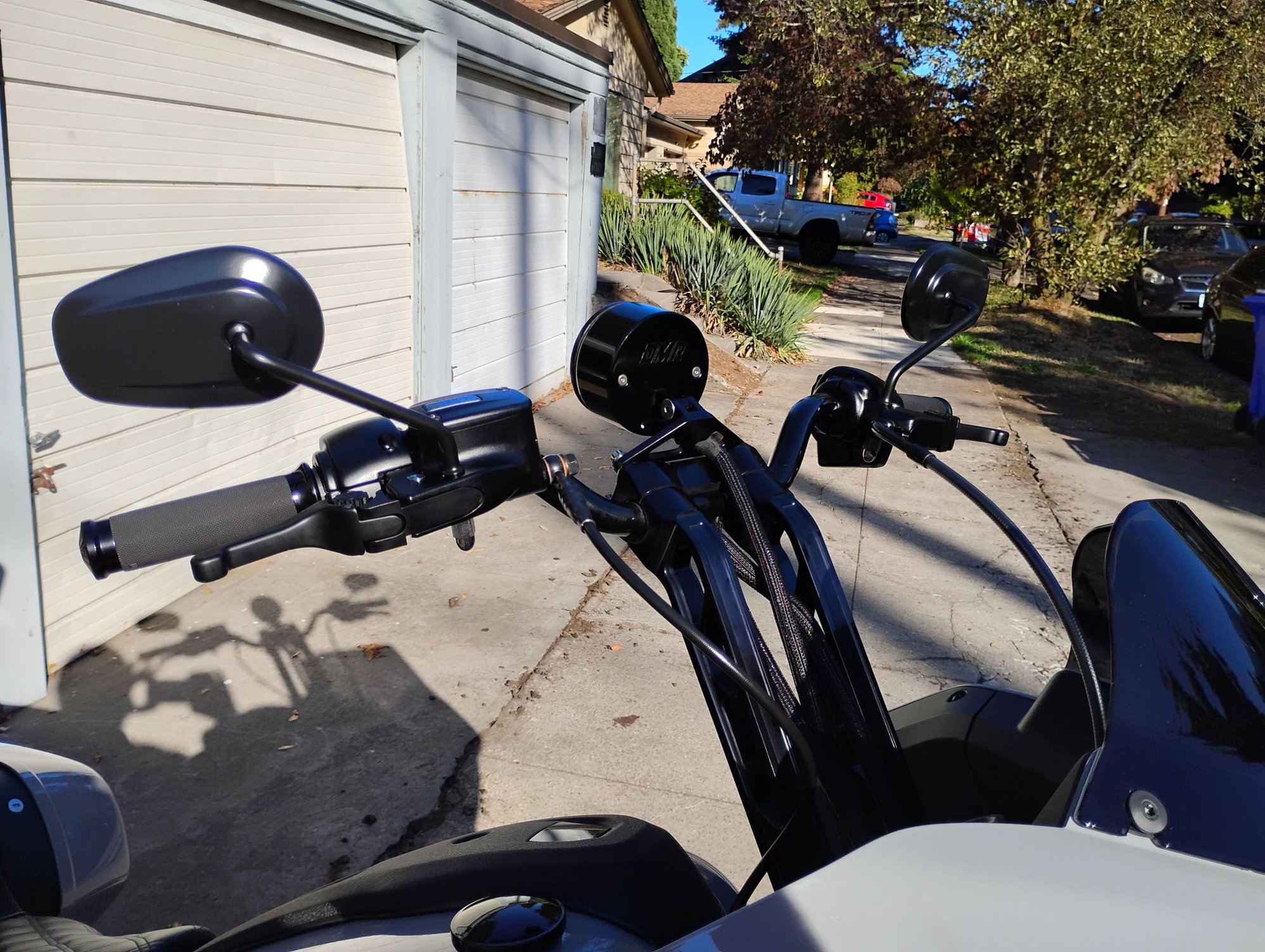

Glad to hear you got it to work. Just did the round S gauge swap onto my '24 LRST and it's been an improvement, but there have been a few hiccups. The main benefits are having a functional tachometer and placing the information in my line of sight and not down there somewhere. The speedometer readout is still white digital text and it blends in with the other white data so I'd say that's not helpful. I'm pretty sure that's going to get me a ticket.
Not sure if it's the wrong gauge, broken gauge, bad wiring, or something else, but the red light is always on, the ABS light stays on for a few miles and the traction control light doesn't ever light. The gauge has the TC icon but it doesn't light, even during the power up sequence. The shop says they flashed it, and they've been good so far and I expect that they'll figure it out eventually, but maybe there is some special software that only the dealer has. That may be the next step but I don't want to go to the dealer, ever, except when I buy another...

Run your hazards for no less than two minutes with just the power switch on not the bike running, will give the bike time to figure out the set up and it will take care of the security light (red) being on all the time. not sure about the other lights as I never ran into that problem. Put an S gauge on my 2023 ST and never did any type of flash from the dealer and it runs fine. Did have the same problem with the red light always being on, then I remembered the hazard trick from an older bike, when changing lights out, so gave it a try. As I said all works fine now. Just did it again on my LRS after changing the front and rear blinkers and it did the trick for me again as all is fine.
Hope that helps with your set up, bike looks good.

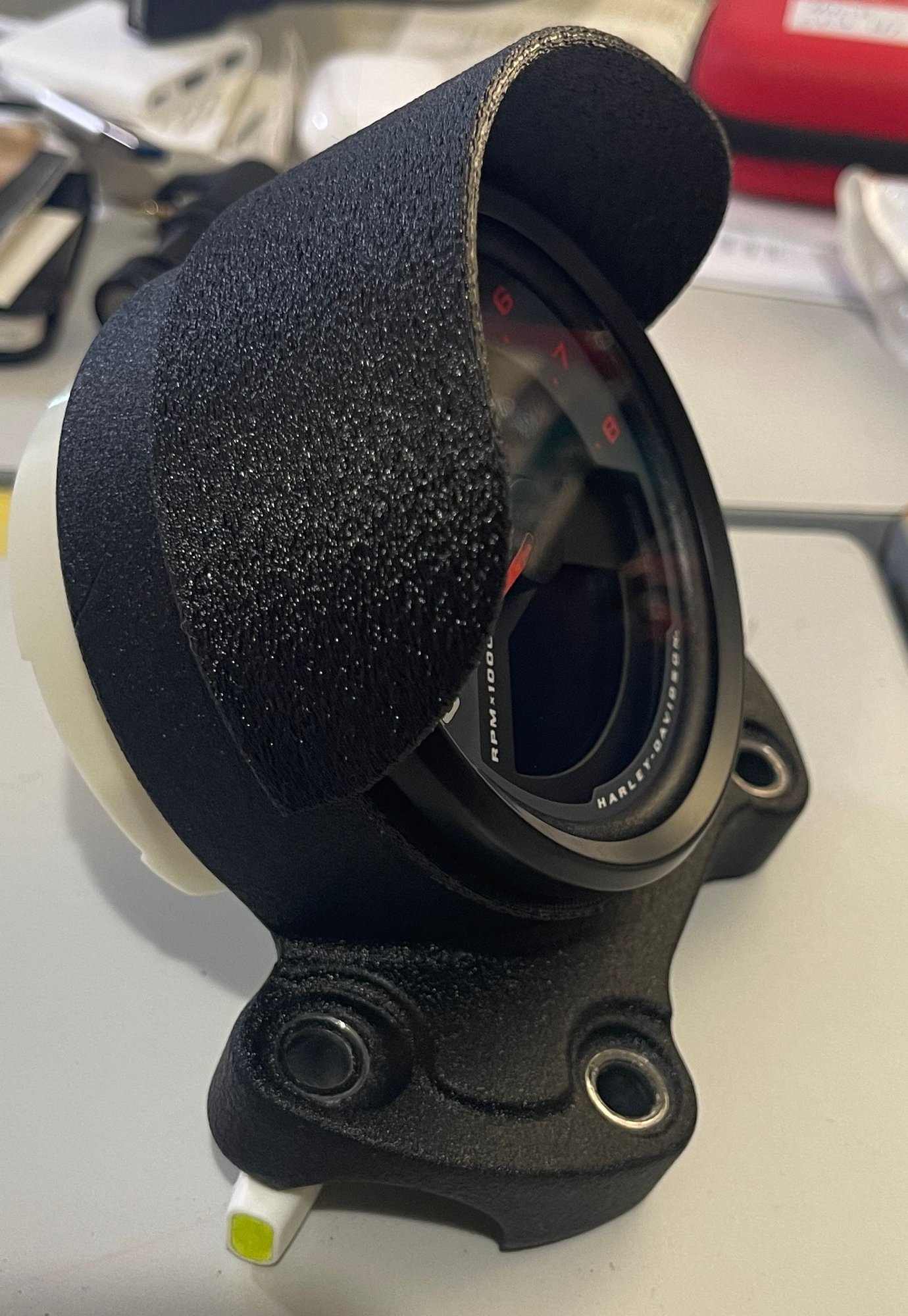

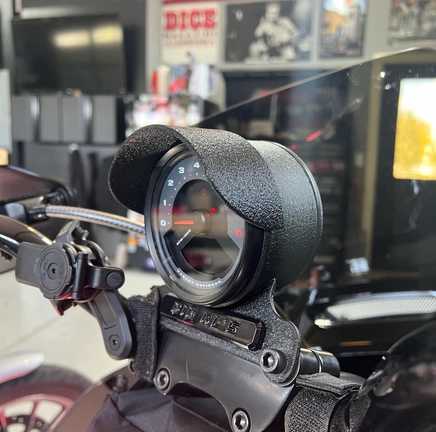

The above mentioned gauge visor from Etsy on a single S gauge (also on dual T Sport gauges.

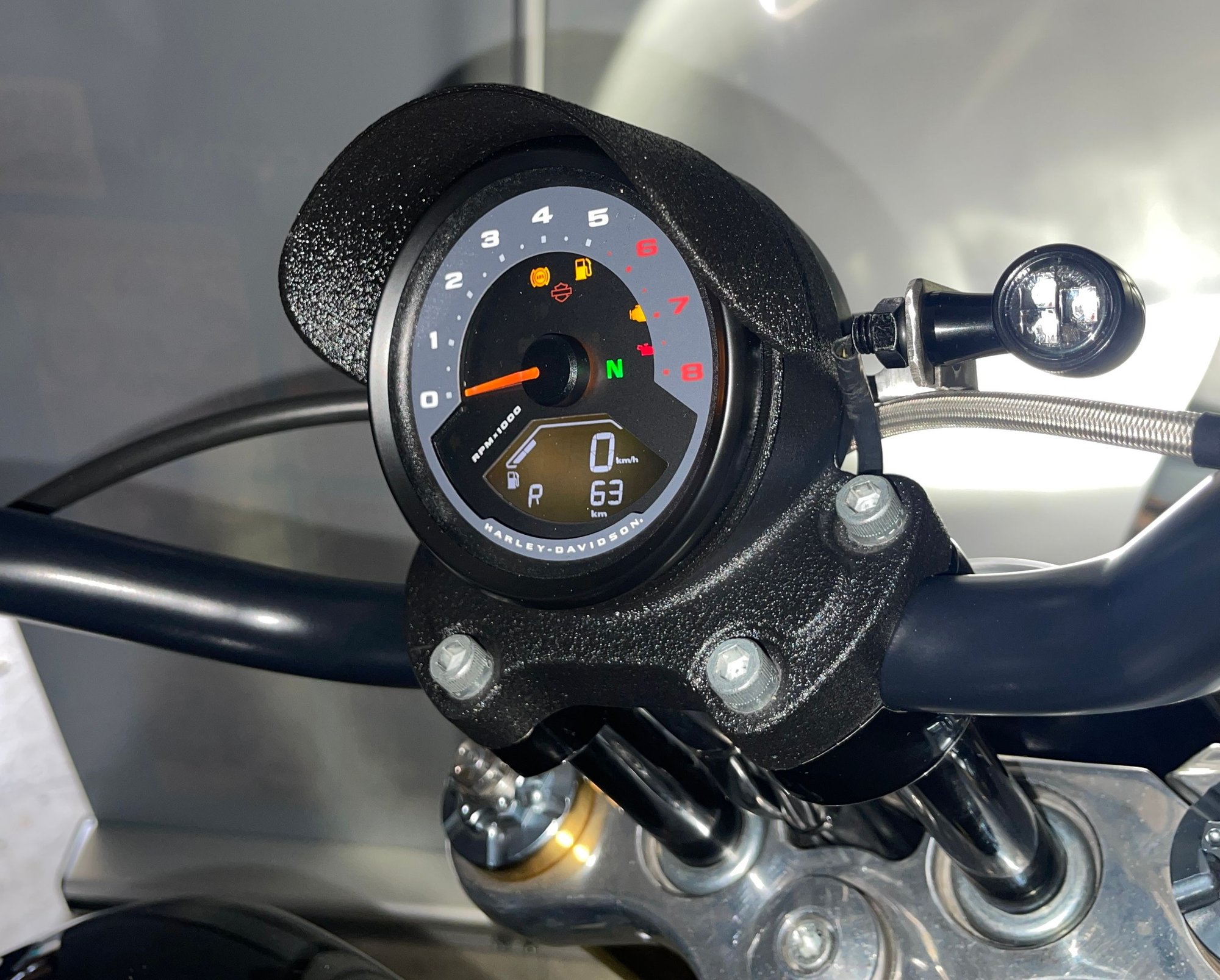

I bought a single gauge visor for my Low Rider S speedo from FHC Equipment in Sweden using this link.
Arrived in Australia within 10 days. Great product, price and service.

Fitted with new 3024 FXLRS speedo, risers and bars on my 2020 FXST. Plug and play.
