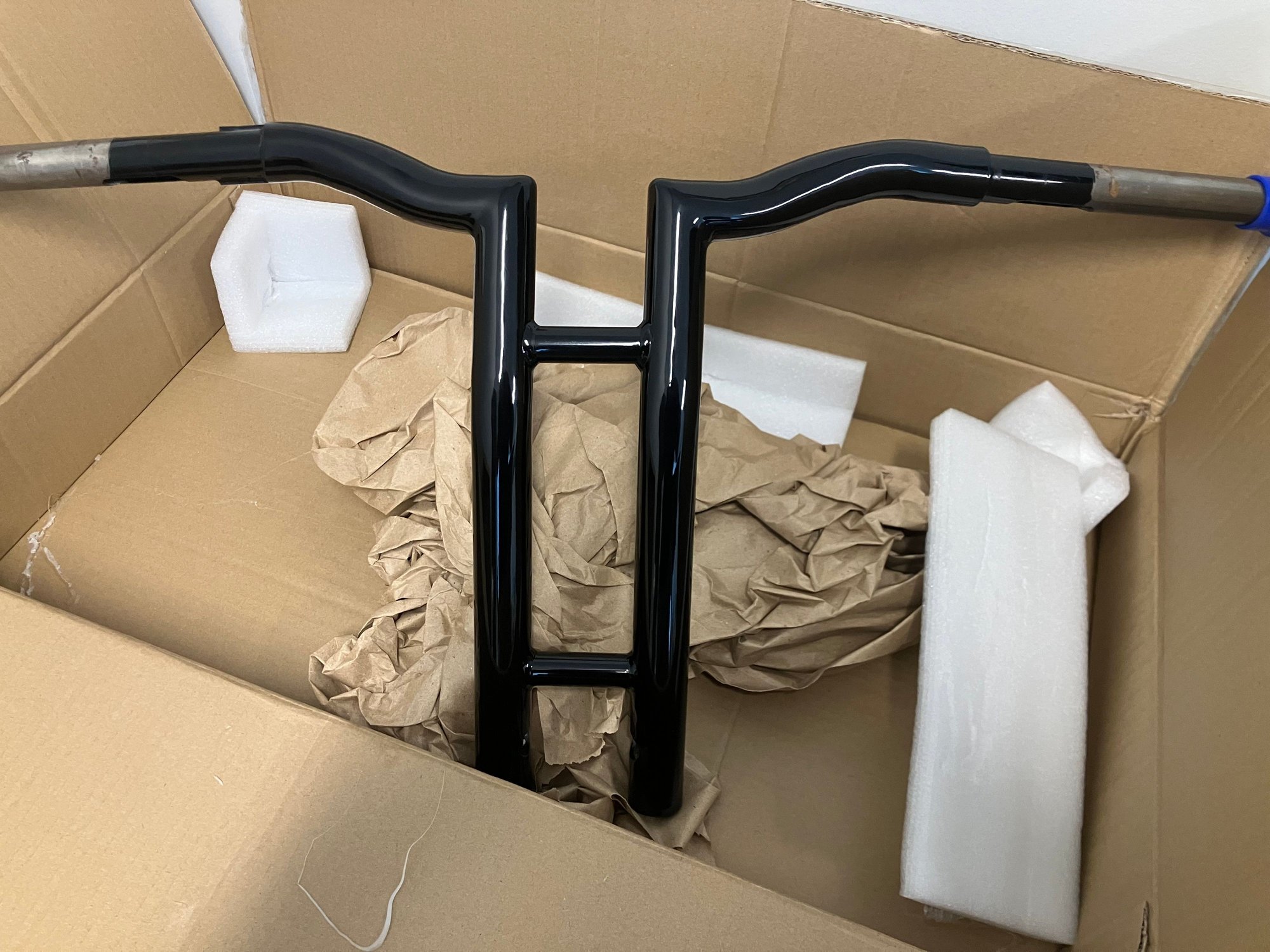

Hey man,
Do you remember how many different plugs/connectors you had in the bars when you got the dominator tbars? I just got mine last night, prewires as well. I went thru it all to make sure they were good and have everything, but, I had 2 connects on on left and three on the right. Based on my manuals wiring schematic, I thought there was only one on the left, and two on the ride, because I need to pull the stock twist grip sensor out and into the new bars.
That would make sense assuming you have to extend the throttle by wire as well. On the left would be the plug for the switch gear and turn signals making 2 on the left, for the right it would be the switch gear, turn signals and throttle by wire making 3 plugs.

Oh I wasn't thinking about turn signals, since they're down under the alley lights. I kept seeing stuff about heated grips, was making me think there was just a extra connector in the bars for them . I'll probably be tearing into it this weekend. Appreciate everyone's help on here!
