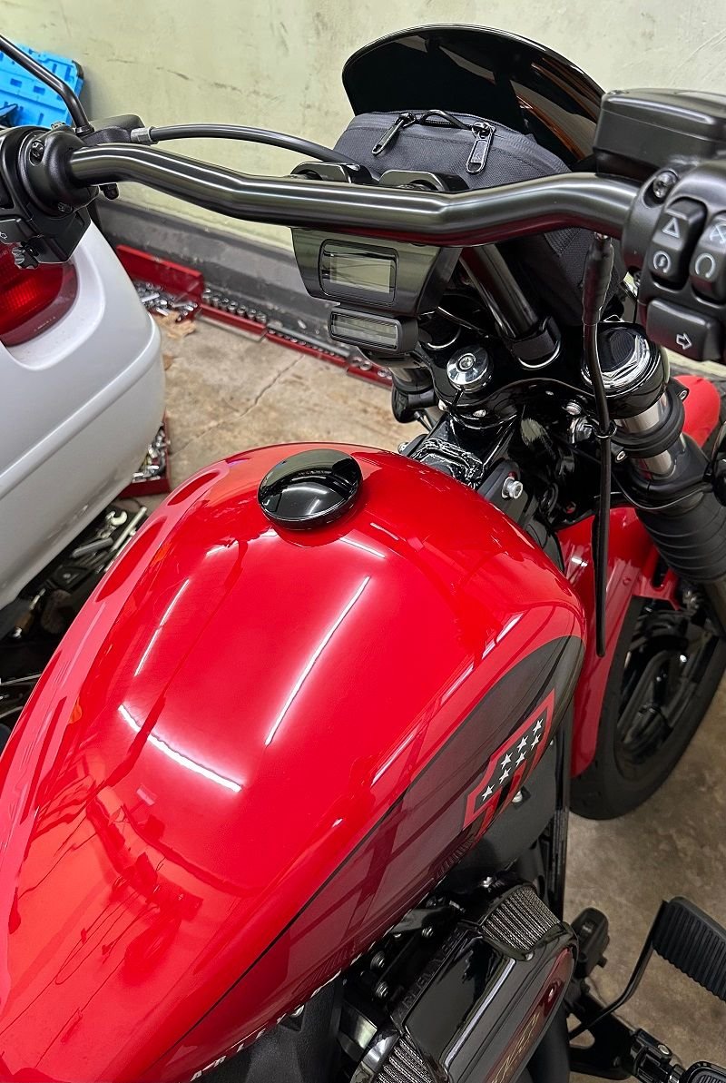

Besides rotating the bars or buying new ones is there a way to get some pullback while keeping the stock display?

I guess I should add that I have a street bob.

plenty of risers are available with the display cut out in the top clamp

pullback top triple tree or a pullback plate will get you pullback without having to change the riser.
the tree is the cleanest and gives no rise, but a lot more money. the plate is cheap but looks kinda chunky and gives about 1" of rise.
this tree is "mymachinist" but thashin supply and original garage both make a pullback top tree.

Be aware that changing the angle of the display might make it unreadable. I can adjust the display angle on mine for best visibility.

There are offset plates that you put in between the risers and the steering head. But they will raise the bar by the thickness of the plate itself, usually about 1/2" or so.
