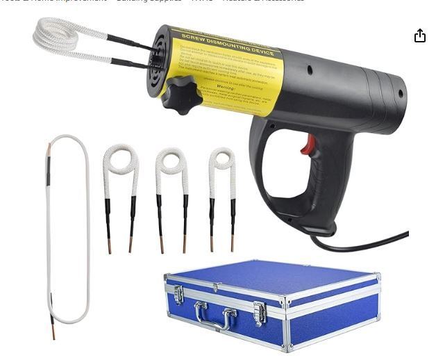

If you have other projects that might have stripped/rusted hardware, an induction heater was the best tool I have had. I sold mine when I got out of old cars, theyre not cheap so unless you got another project that would have use.
I'd take off the footboard, cutoff wheel the head, and just use a typical left-handed screw out kit.
