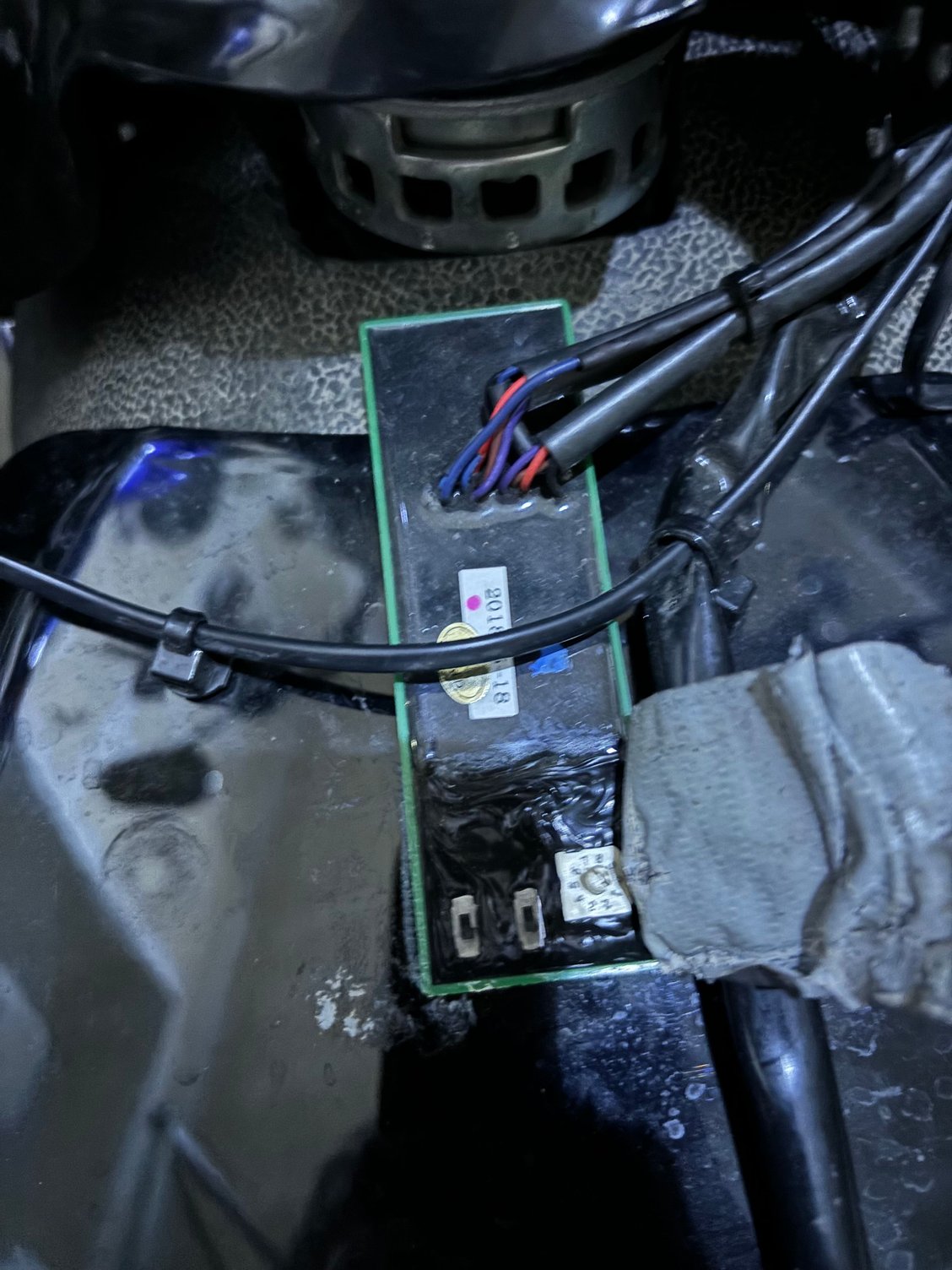

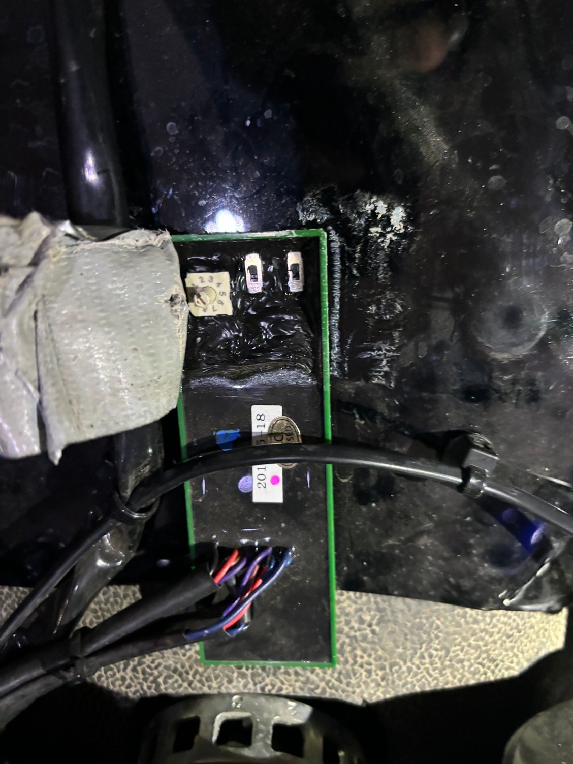

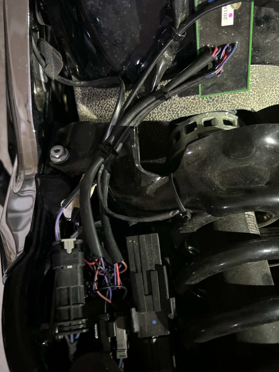

I bought a ‘19 FXLR last weekend with 2230 miles on it. It’s mostly stock other than some Kuryakyn bling parts I’m removing.
However, I found this module under the seat held down with strong 2 way tape and with duct tape covering up some jumpers. It appears to be wired into the turn signal harnesses although I’m not sure yet. I’m unfamiliar with the bike and can’t yet fully tell what’s normal stock Harley electrical wiring stuff and what aftermarket electrical wiring was added. I bought it from a dealer so there’s no way to contact the previous owner. I’m guessing it might be some kind of load equalizer or controller for LED bulbs that were removed before trading it in.
It didn’t come with an owner’s or tech manual so I’ll be getting those and perusing them thoroughly, but in the meantime I was hoping to tap into the vast knowledge base here.
Everything works normally but I want to remove it if it’s superfluous and restore the wiring back to normal for reliability reasons. From what I’ve read so far and seen in online videos, the newer Harley’s can adapt to LED turn signal bulbs on their own and don’t need load balancing resistor modules like the old days. I’m not sure that’s what this, it’s just a guess. Has anyone ever seen something like this?

Try searching with the part number on it. I have found out what things are by doing that, But hopefully someone can give you an answer.

Looks like it is going into the STT (Stop/tail/turn) connector so probably some aftermarket lights or a pulser or something like that. Like one of the things that will flash the brake lights when you first apply them. That would be my guess.

Turn it over and see if it’s got a brand name on it.

that there looks like a custom dynamics triple play module

This was my 2nd guess. This looks like my Custom Dynamics Magic Strobez LED flasher module I got on my bike.

I think you’re right. This instruction sheet sounds exactly like what it looks like and does. Thanks!!
