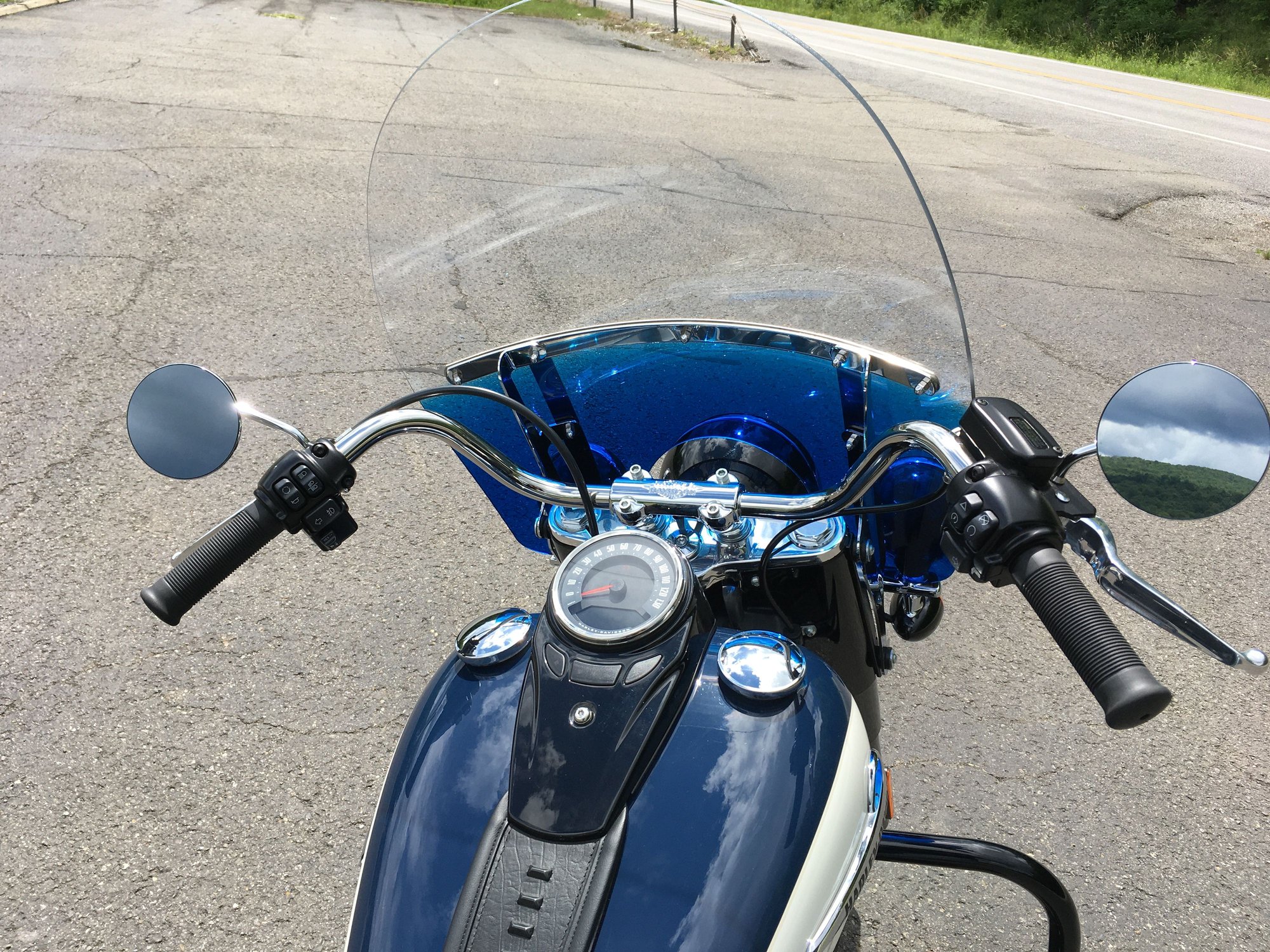

They weren't cheap, but I installed Helibar's on my 23 Heritage. It did require new wire extensions, and a new clutch cable and brake line.
https://www.helibars.com/harley-davi...rley-davidson/
The brake master cylinder has some clearance problems with the line fitting. It doesn't prevent use, but it does limit the adjustability.
After god knows how many hours of fiddling, I've got my hands back, and close together, and angled downwards to the outside. So, almost perfectly neutral, for me.
