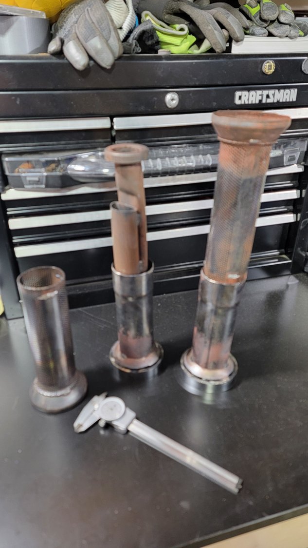

That's the baffles after I cut mine out. They are restrictive, and slip on will open it up... But the cats are the size of the can and allow plenty of flow. That's all welded in, so you would just go in from header side, and ream out all the cat... But it's just not going to do much... Even if you got all of it... Which isn't guaranteed... I mean it's tight.
I would never think slip on would do much, but after going through everything I did with cutting out baffles... Of yes, it does really open up and M8s really benefit. If you think they are too loud... You can see if the baffle has a removable insert and if you can wrap with fiberglass to quiet down... Or just see if you can throw them on and see for yourself.
