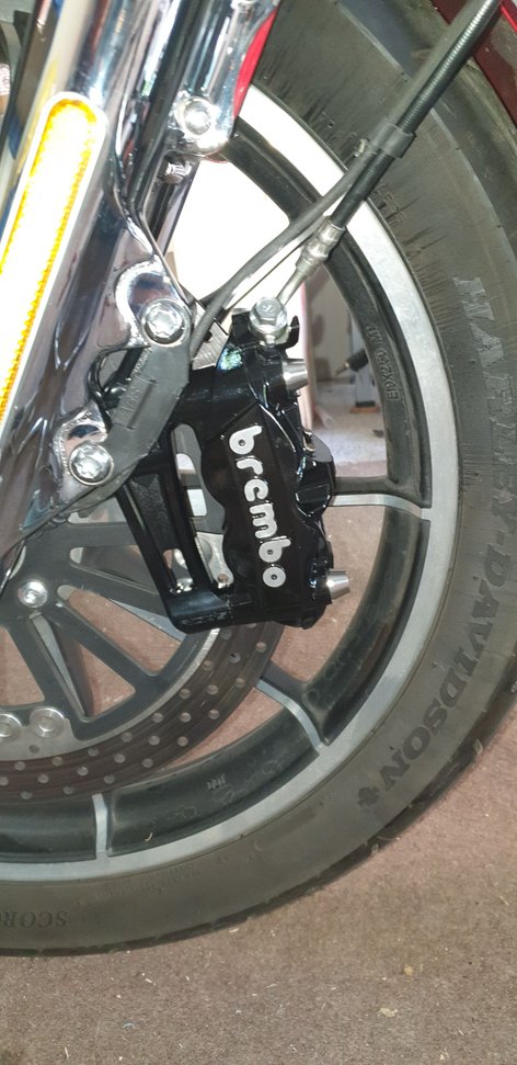

I'm not trying to talk you out of this I am just going to tell you my experience.
I put a 4 piston 4 pad Brembo caliper on my 2003 fat boy thinking I would get unbelievable stopping power.
Not such noticeable increase in stopping. The lever feel was very abrupt, master cylinder piston too big. Which made me switch to a Sportster caliper with a smaller piston, this gave me the lever feel back.
Better but still not great. I then I installed a 12.6 inch rotor.
So now I'm running a Brembo 4 piston 4 pad caliper on a 12.6 inch rotor with a 1/2" master cylinder I have great lever feel and awesome stopping power.
But to do all this with ABS brakes, that makes me a little nervous. But it was great fun and it worked.

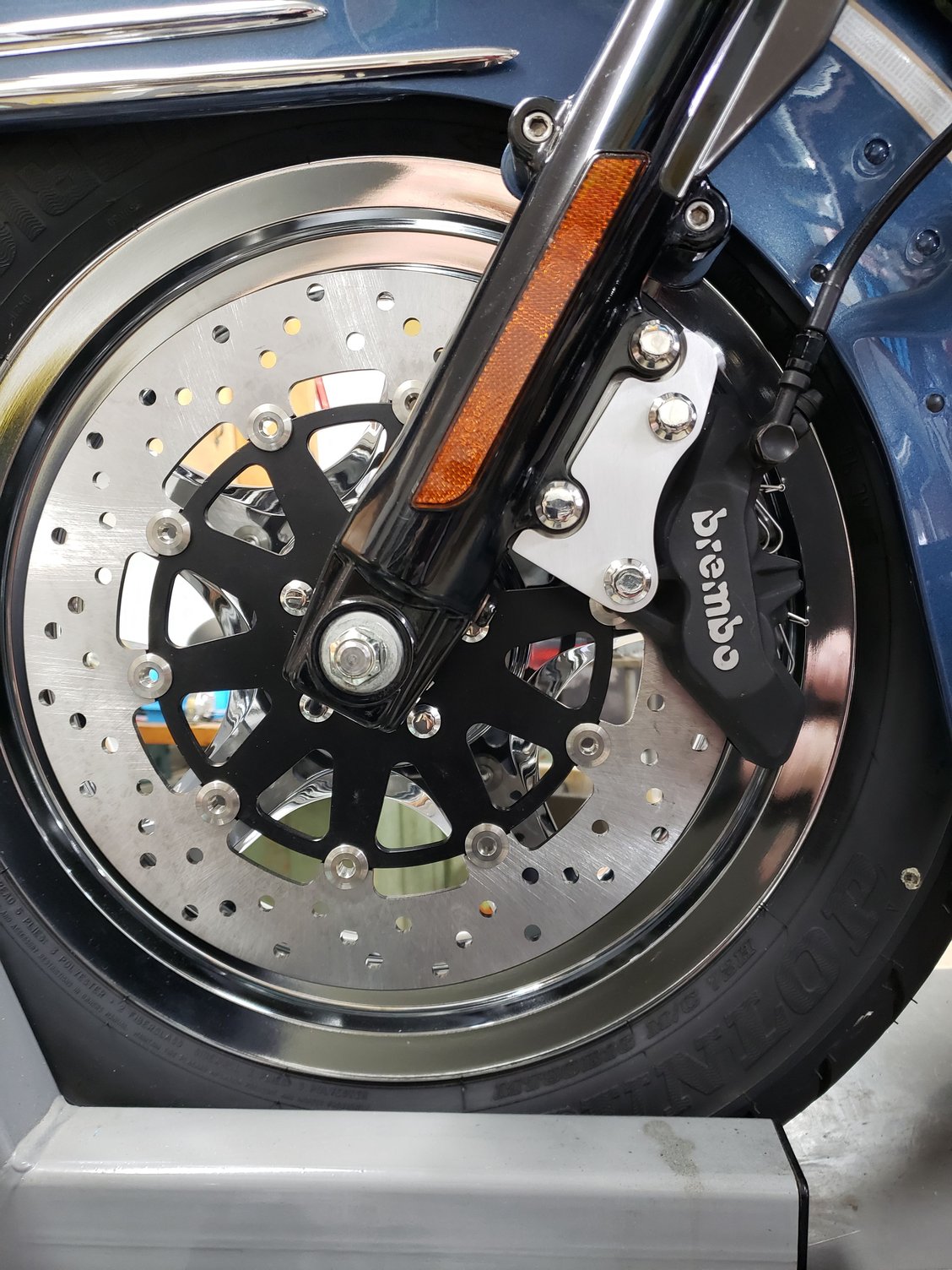

tunderbike rotor 340mm original nissin caliper thunderbike rotor 340 mm ricks motorcycle bracket and brembo ( from suzuki gsxr ) ebc pads  (no need change brake line )
tunderbike rotor 340mm original nissin caliper thunderbike rotor 340 mm rick's motorcycle bracket and brembo ( from suzuki gsxr ) ebc pads (no need change brake line )
whith same 4x32mm calipers ,the strenght , the stiffness and the power of brembo caliper is enormously better ( on low rider 107 )​​​​​​
