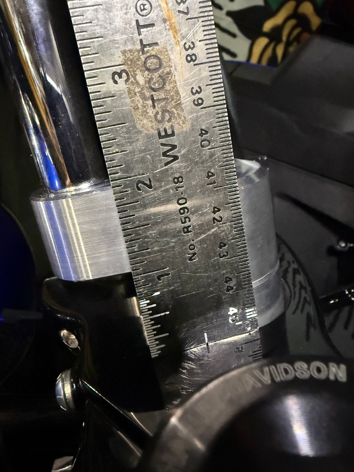

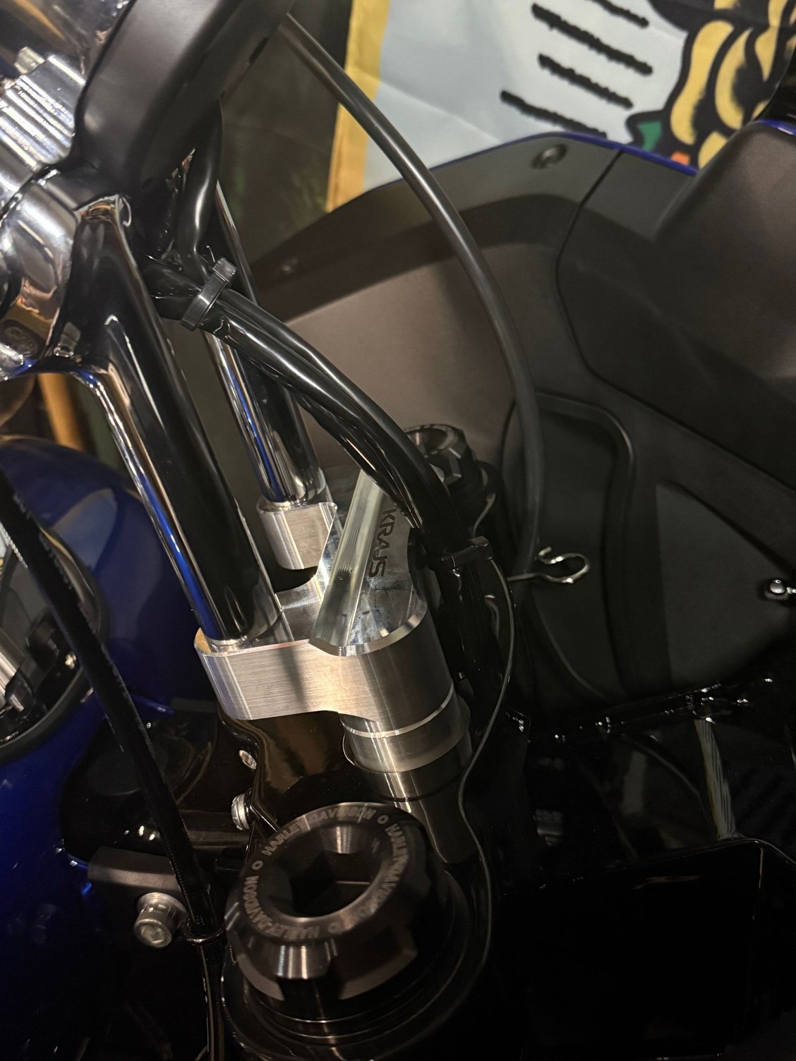

Got that Kraus Raptor Plate installed - adds 2" of height and 1-1/2" of pullback.
Wiring is no issue; however, the brake line is just a bit tight.
Definitely feels better; this will work until I can get some new bars and brake and clutch extensions.
