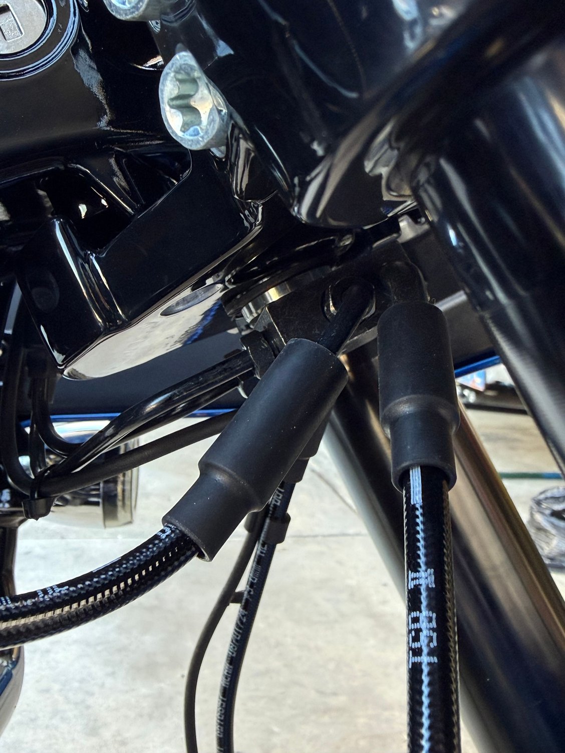

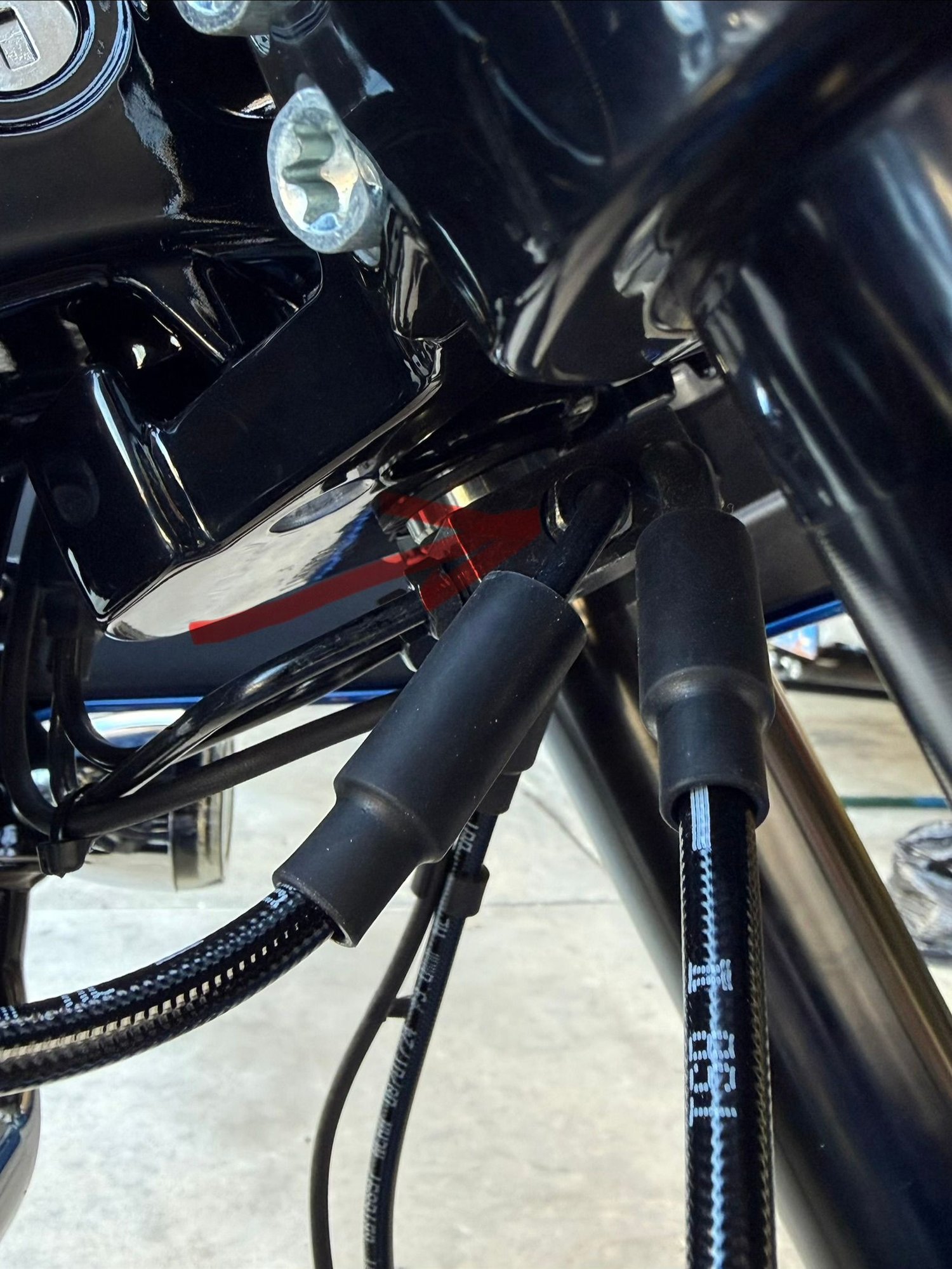

Old Nov 10, 2025 | 02:41 PM
Road Star's Avatar
Road Star
Joined: Dec 2012
Posts: 6,665
Likes: 502
From: Orange County
Originally Posted by $tonecold
There is enough slack in the brake line for about 12" of rise. That is what I have on mine and I'm still running the stock brake line. I did loosen and adjust it. If you change it out you will need a device to such as the TwinScan 4 to bleed your brakes with ABS. This is probably cost prohibitive unless you plan on doing this multiple times.
Looks like I could break loose this fitting for the brake line and rotate it slightly upwards. That may give me an extra inch or so. Is this what you are referring to?
