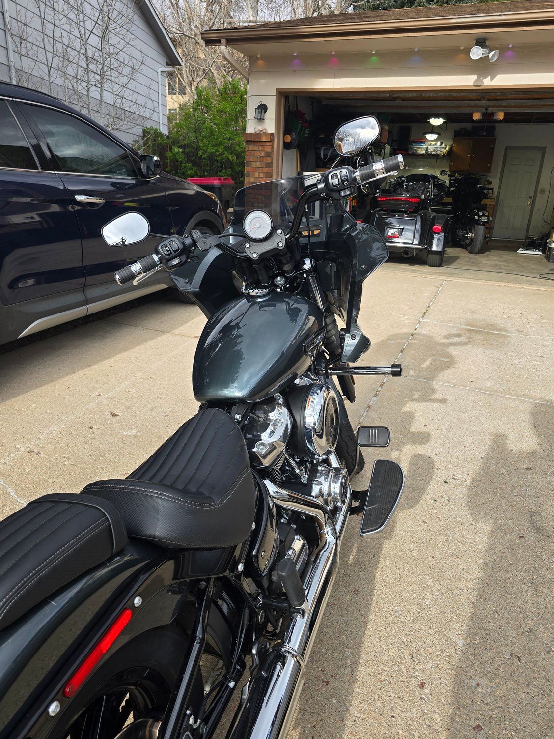

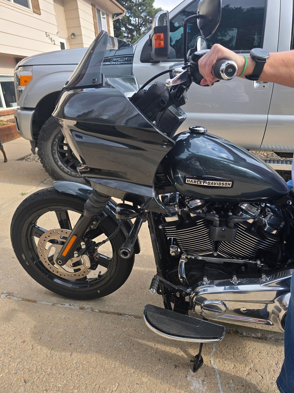

Ya, here ya go. She is much happier. I think its more like a inch higher. Plus now there is room for a handlebar bag.
I pulled them back a little from there... Back and lower.
