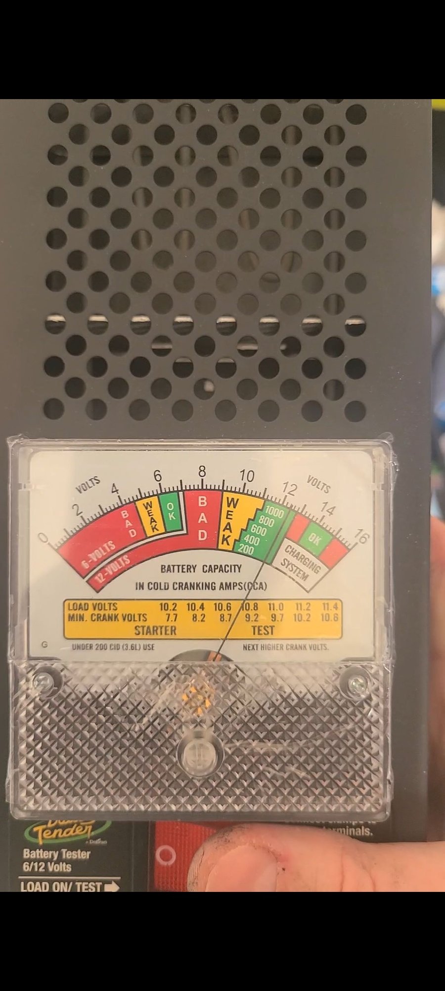

how does this look? battery was fully charged from the 5 amp tender and removed from the bike to test.
before load
before load
during load
during load
