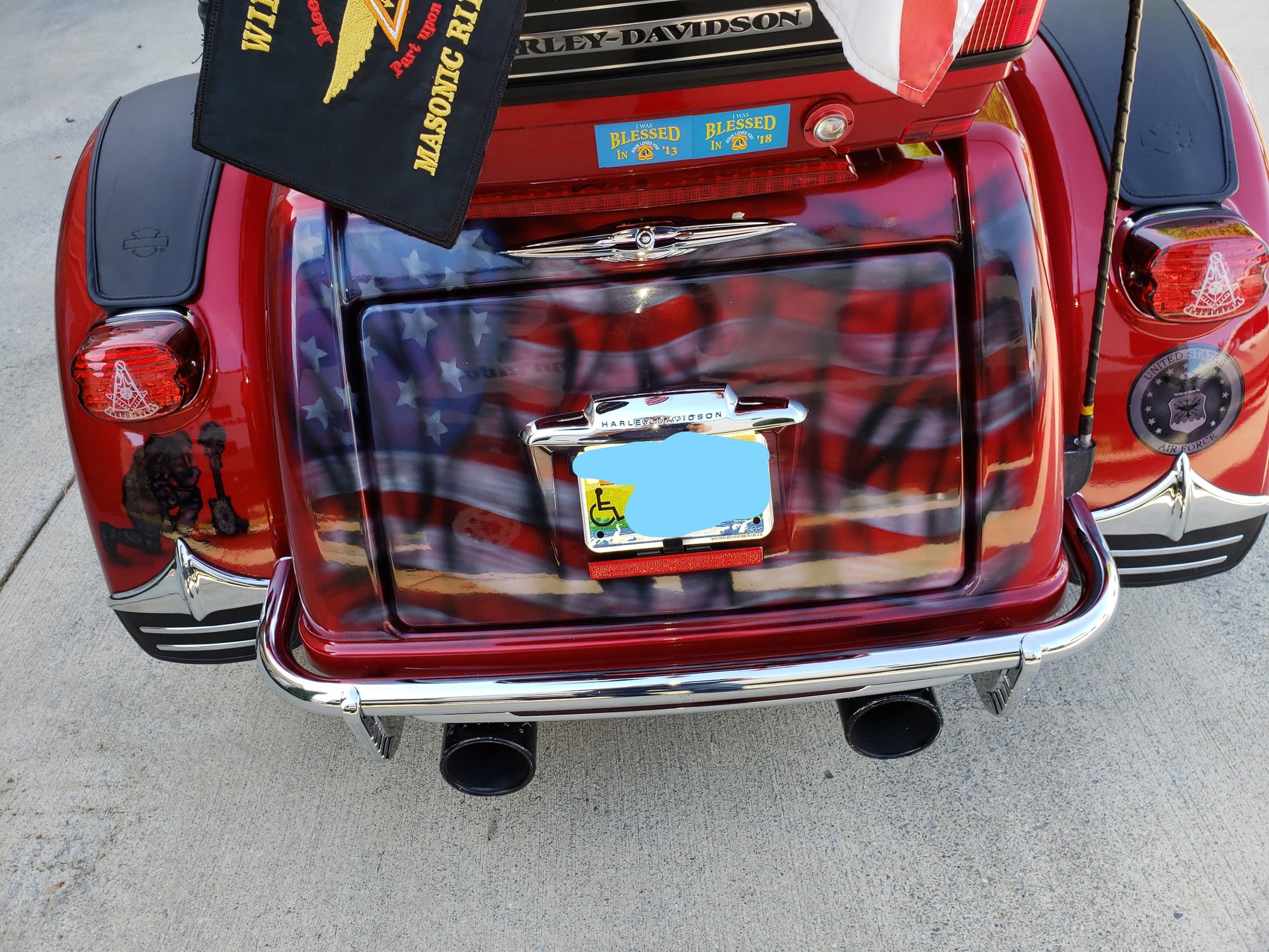

I am looking to upgrade the Air Shocks on my 2012 Tri-Glide does anyone have any suggestion? Someone posted in this forum "why would anyone want to lift their ride?" I have a problem with dragging my pipes when loading or unloading the Trike into my Toy Hauler and on speed bumps and need to lift it JC Baggers said that their shocks can lift 1100 lbs but didn't say what the lift was. I only need a couple of inches. Plus being able to adjust on the fly seems like a great idea for a trike. Hard to see here but pipe ends are ground flat from dragging.
