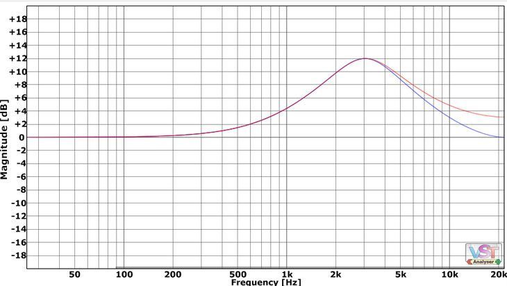

below an example of an EQ that has a +12db turned on on 3000Hz (3kHz) with the rest all flat.
the more frequency channels you have on a EQ the more you can fine tune the sound.
My Deck got a 5 channel fixed frequency EQ.
now loudness is for example a sort of EQ setting that will boost only highs and lows. hence the reason you need to DISABLE that on your Bike unless you play at a really low volume ().
