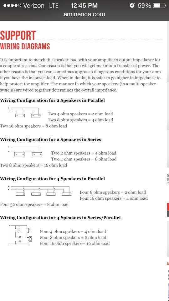

Just making sure before I button this up. Run both 4 ohm speaker leads to positive and likewise for negative to achieve best use of 2 ohm head unit? Thanks in advance

You are correct sir.
