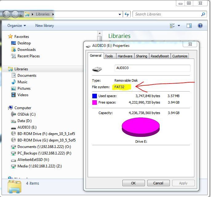

here we go - Computers for dummies LMAO... Right up my Alley, as I am in Software...
put your stick in a USB port, open you windows explorer, right click on the "drive" representing your USB Stick (in my case it is AUDIO3) and select "Properties".
you should see the File System Value as FAT32.
If not, then close this window and do a right click again on the USB stick "drive" and now select "Format". Make sure it FAT32 and while at it give the drive a name in the Volume Label you like.

It comes up as exfat that's what the other memory sticks are formatted as. The new one comes up with ex fat and a few others the existing one only comekilobytes xFat default or 128 kilobytes. I try changing the format again and it still comes up with no device
