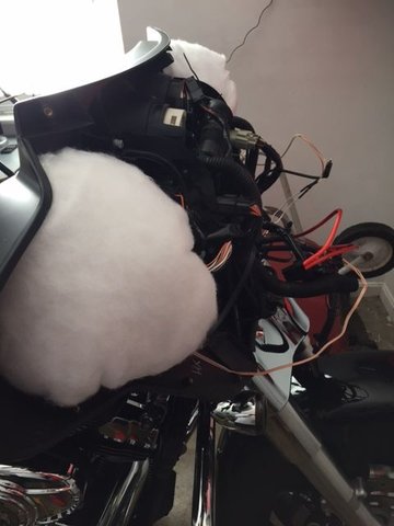

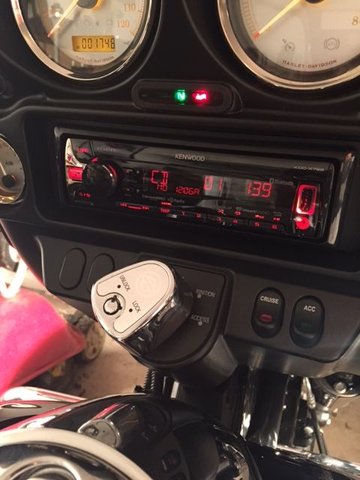

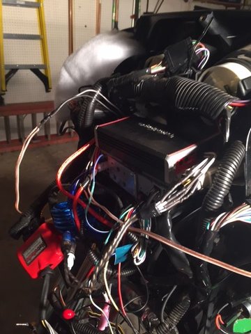

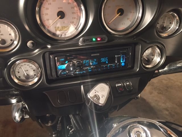

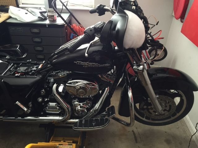

new stereo arrived this evening, went ahead and put it in. Its mounted with 3 of 4 bolts, will try to get the 4th one tomorrow VERY irritating. Unit looks great with the metra kit. The stock head unit bezel isn't snapping into place 100% yet.
Sounds great! Bluetooth is sweet! and plenty of features which I need to play with still. I'll need new RCA cables the ones are TOO LONG. The bt1005 isn't working all my connections were solder. Checked everything twice and my wiring is correct, the stereo works perfectly fine just no hand controls. Any advice on this before contacting Bill at bike tronics?
side pic ,
polyfil
front , not finished mounting amp or bundling wires
Metra kit, the radio bezel was difficult to place on & still alittle loose I think will need to play with it
kenwood unit

What leads did you solder? Should only be the speaker wires to the Amp. Wires from the radio are pluged directly into the BT1005X but you must have an older model. That could be the problem.

Interested to see if you find a solution on the trim bezel. When I helped my buddy put a Kenwood M312BT unit in his bike with the Metra kit we weren't able to get the bezel to stay on either.

Parts of the bezel does snap in but its still a tad loose. I'll probably snap in what I can and use double side adhesive to hold the rest in place. It looks good both ways but I think I prefer to have the bezel in place.
