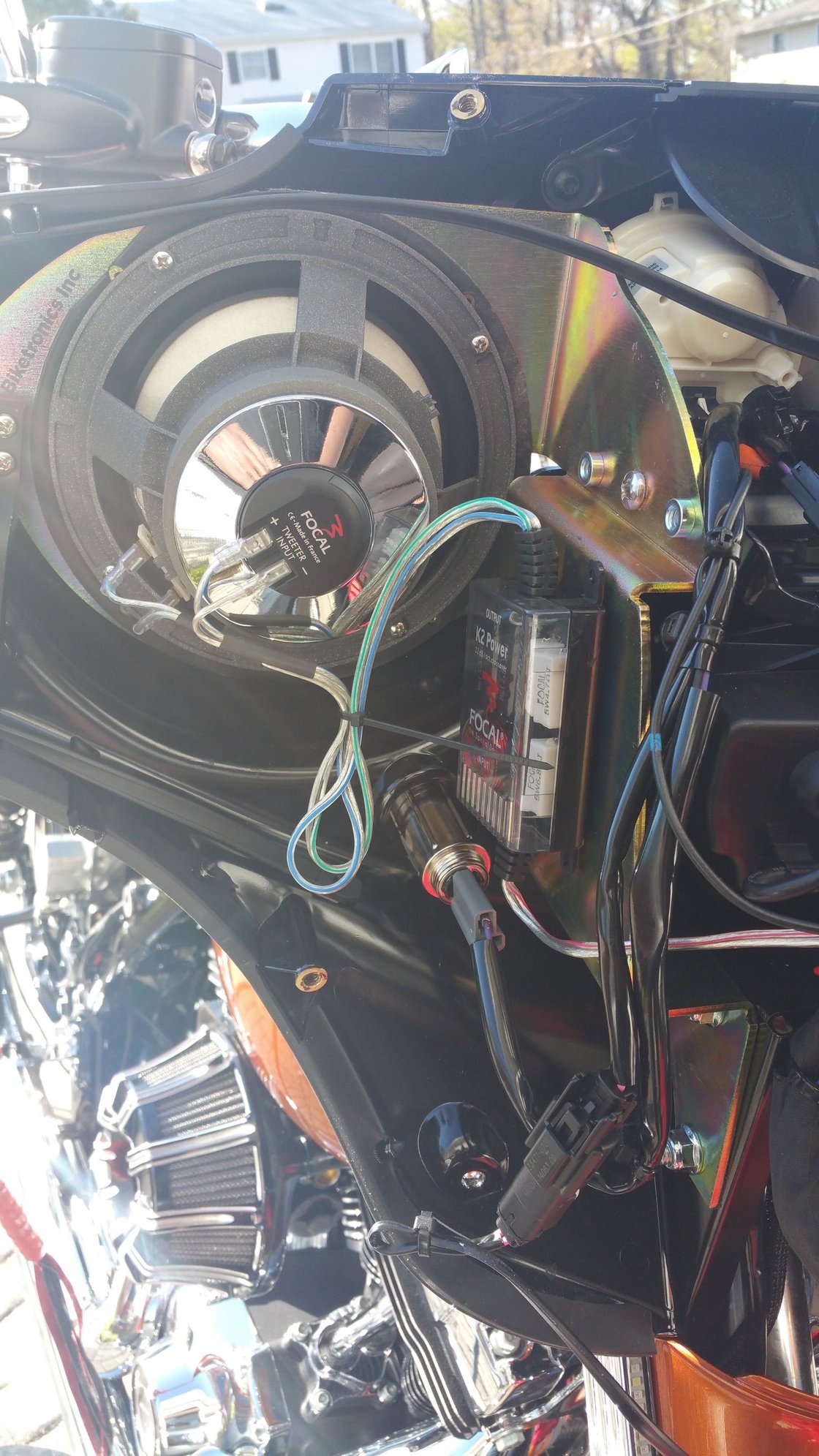

Originally Posted by Vision
If you're using the biketronics brackets, a small surface becomes available between the bracket and the back of the fairing speakers. I'm currently using it to mount the crossovers for my Focals.....using the factory pods, no chance.

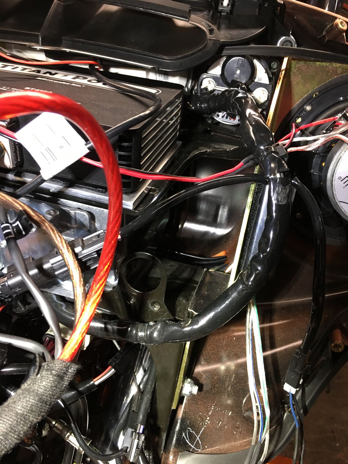

We've been paying attention to the front right of the bike, butthere is even more room on the left side. Right next to the stock head unit, I swear there is enough room to put my old Diamond micro 4 and definitely a CV b54. I actually caught a shot tonight.

Originally Posted by Bertk
Get a block of wood or even Styrofoam and give it a try.
Didn't have a block of wood, but I actually took my old amp and slid it up in there. Might not be a perfect fit because of that circular loop that comes up from the bottom of the HU tray that you can see in the first pic, but you can definitely make it work. I know for a fact the CV b45 amp that I mentioned is a tad smaller than its cousin, the Diamond Micro 4.
