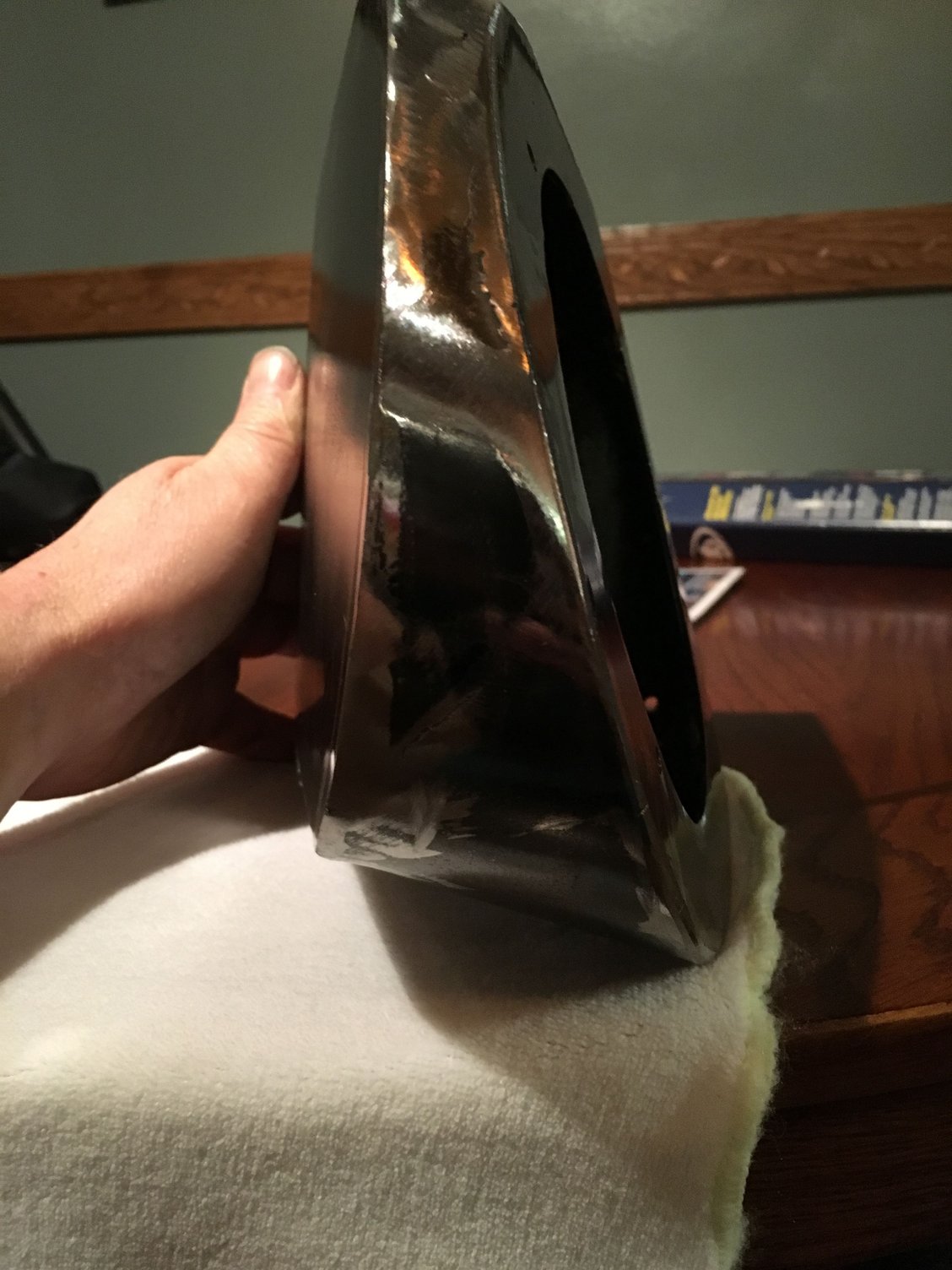

one assembled and welded. leave outside corners open for a full penetration weld. no worries when grinding the corners to a radius
partially sanded. DA sander next the perhaps a little filler before it goes to paint. next pic will be of them still unpainted, but mounted to pak. you will notice how much room i gained in the space between the pods compared to other pre-Rushmore baggers

Looking good yooper, amazing work!

Wow! That's art... Nice job.

thank you both. ill be sleepless til they get painted. lol
