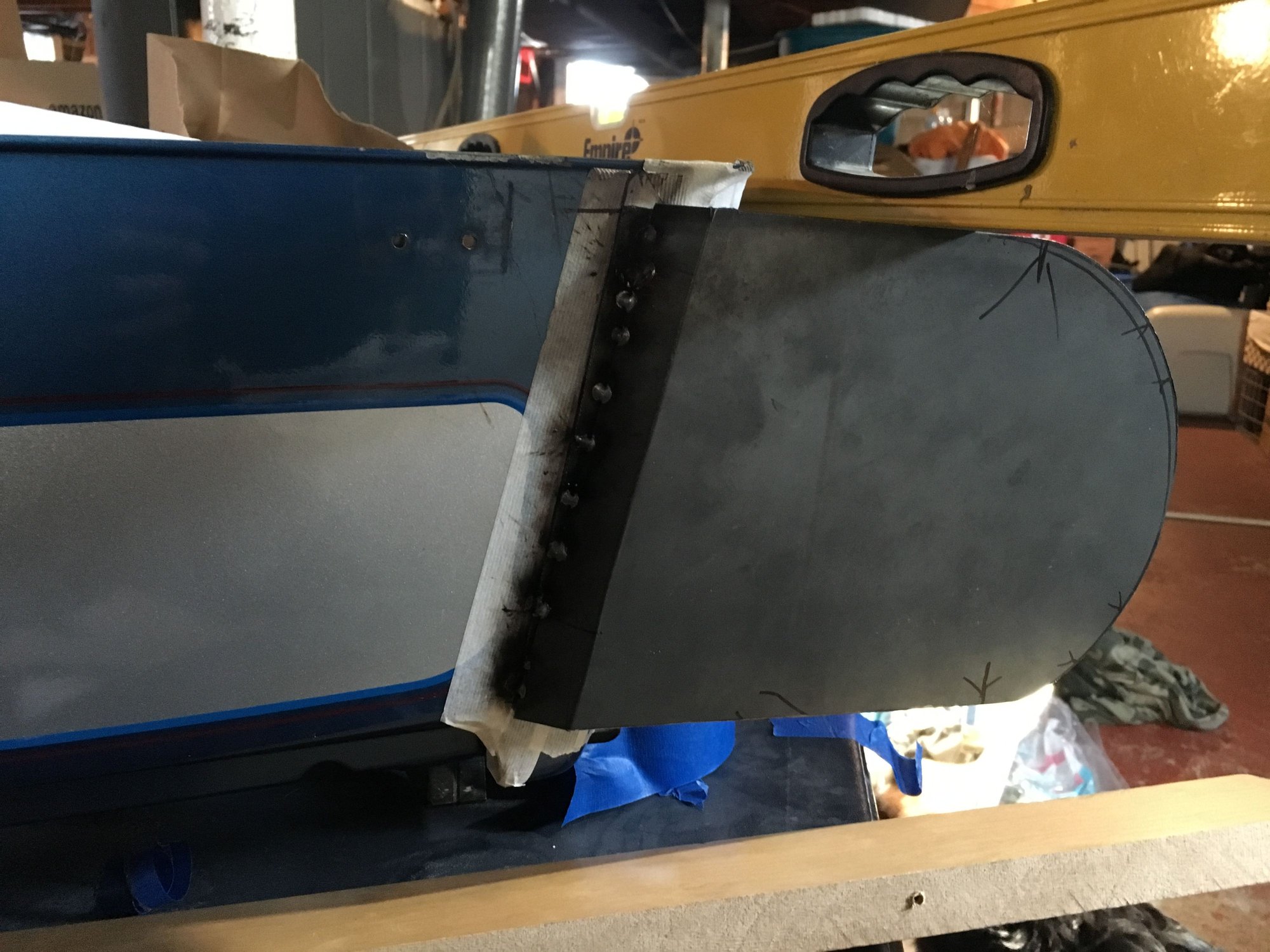

if i had to do it again, id go with a simpler design. from the pics you can see i decided to "wrap" the pods around the front corner of the pak. this will give them a bit more stability, but my main reason was to increase the width between the pods for passenger comfort. with some fanagling and lots of putzing, i managed to gain about 3 inches of space between them. keep in mind that i am using hogtunes gen 3 6.5s back there with the new smaller magnet. just my choice. also notice i added a 4th bolt and weldnut to the pods. more pics as they start to take shape.

While you are still in the fabrication stage still did you think about possibly porting the pods into the tourpack for some added bass?
Looks like you are in the right track.
Looking good so far. I'm interested to see the final product.

well, after talking to Pez at hogtunes, he recommended putting some polyfil in the cavity after i put down the dynamat. ill try that first
