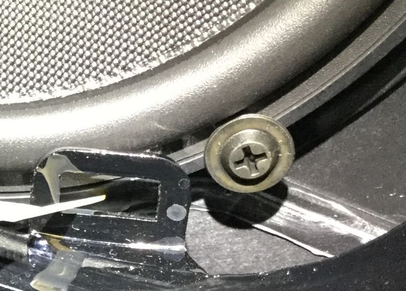

Originally Posted by ScreamingSkulls
Second picture
I wouldn't use those screws. There much to close to the surround of the speaker. When the surround starts pushing out when in use they could come in contact and destroy the speakers.
I used the screws that came with the Kappa's. Thanks thou.
But by looking at that pic you can see how close the tab is to the speaker. I'm worried that by putting a speaker adapter in the equation that it's only gonna get closer. I'm gonna take Gannicus word for it and get em if it helps.
Hahaa if I would have know I was gonna drop another $100 for grilles and adapters I could have just bought the Arc moto 602s lol
I couldn't tell how close the tab was to the surround in that pic. Anyhow you don't want anything coming in contact with the speaker.
Ok.
Yeah the plastic tab for the grill is actually touching the foam ring on mine.
