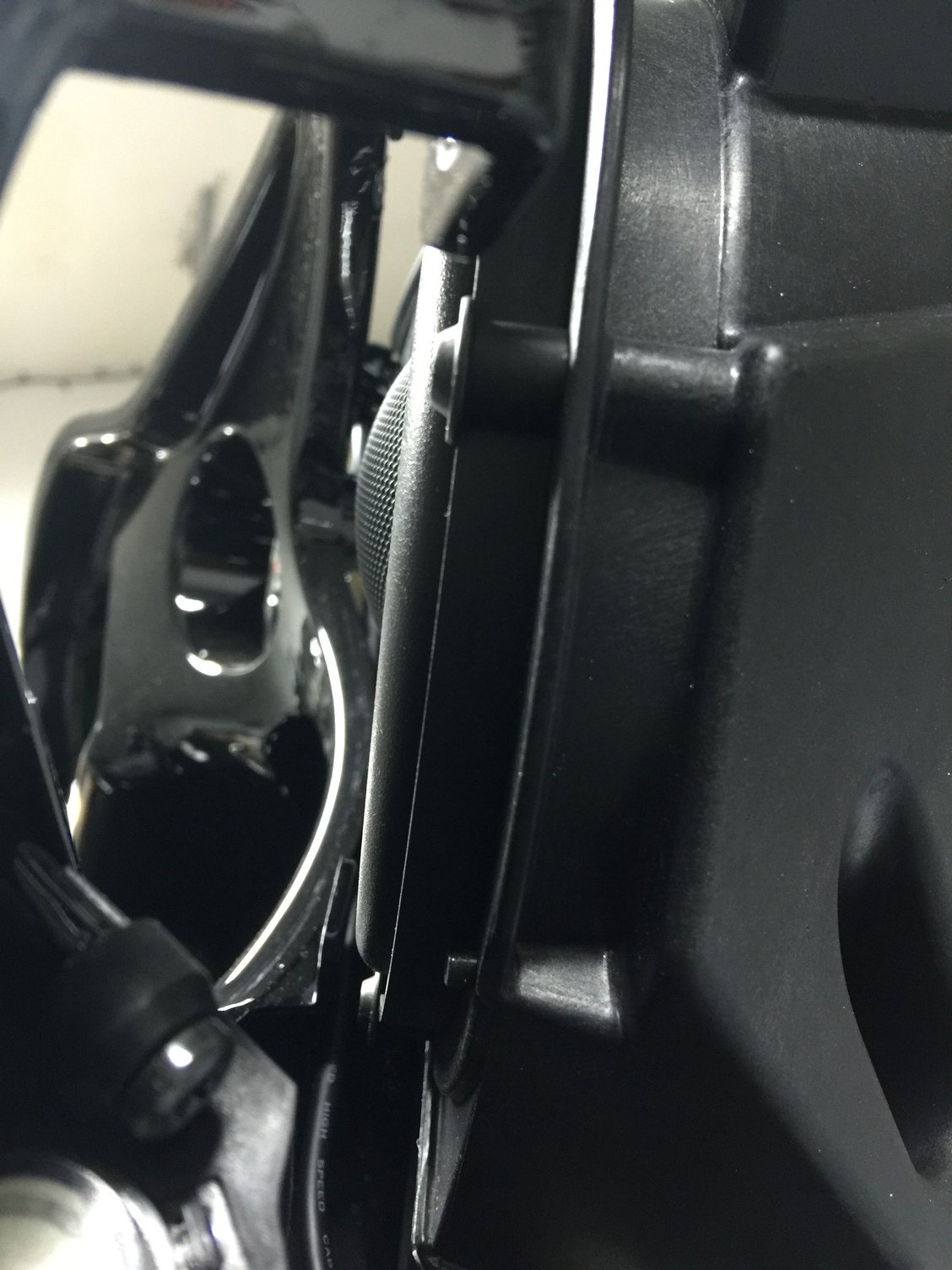

So kappas fit fine but stock grill snap hits speaker ring at 5 oclock on left and 7 oclock on right. I've searched but haven't found anyone else that solved the problem. (Tweeter has clearance) The top of the stock grills clip in but bottom sits in but doesn't full clip. I thought about dremeling a little dimple off the outer top right of the kappas.
Thoughts?

Stock speaker grill hits speaker ring where tip of zip tie is. Won't allow the grill clip to fully snap in.

They are 3/4 trim screws from auto parts. The stock are to short. The screws sit tight and so does the speaker. Here is side view of the speakers showing they sit proper. The screw isn't close to the clip.

I'm thinking that if the speaker itself is not in contact with anything you should be good to go, meaning grind a little bit off the outer plastic ring so u can get the needed clearance for those clips. Infinity is damn proud of those thick damn rings, and those look thicker than normal.
I remember grinding just about 1/16 off the edge of my 6x9 Kappas to get the to fit in my lids.
Dremmel away!!!! A bench grinder might be less risky?

So here's the deal on Rushmore Road Glides, it gets tricky with speakers. I had the Kappas and you can work them into position but it's tight and 99/100 the tabs hit.
The easiest way to fix the problem with the Kappa's or any speakers for the Rushmore RG is to just buy the Biketronics adapters. I think they are like $50 (don't forget the HDForum discount), problem solved.

BTW Hogtune grills give extra clearance, come in the Biketronic RG package
