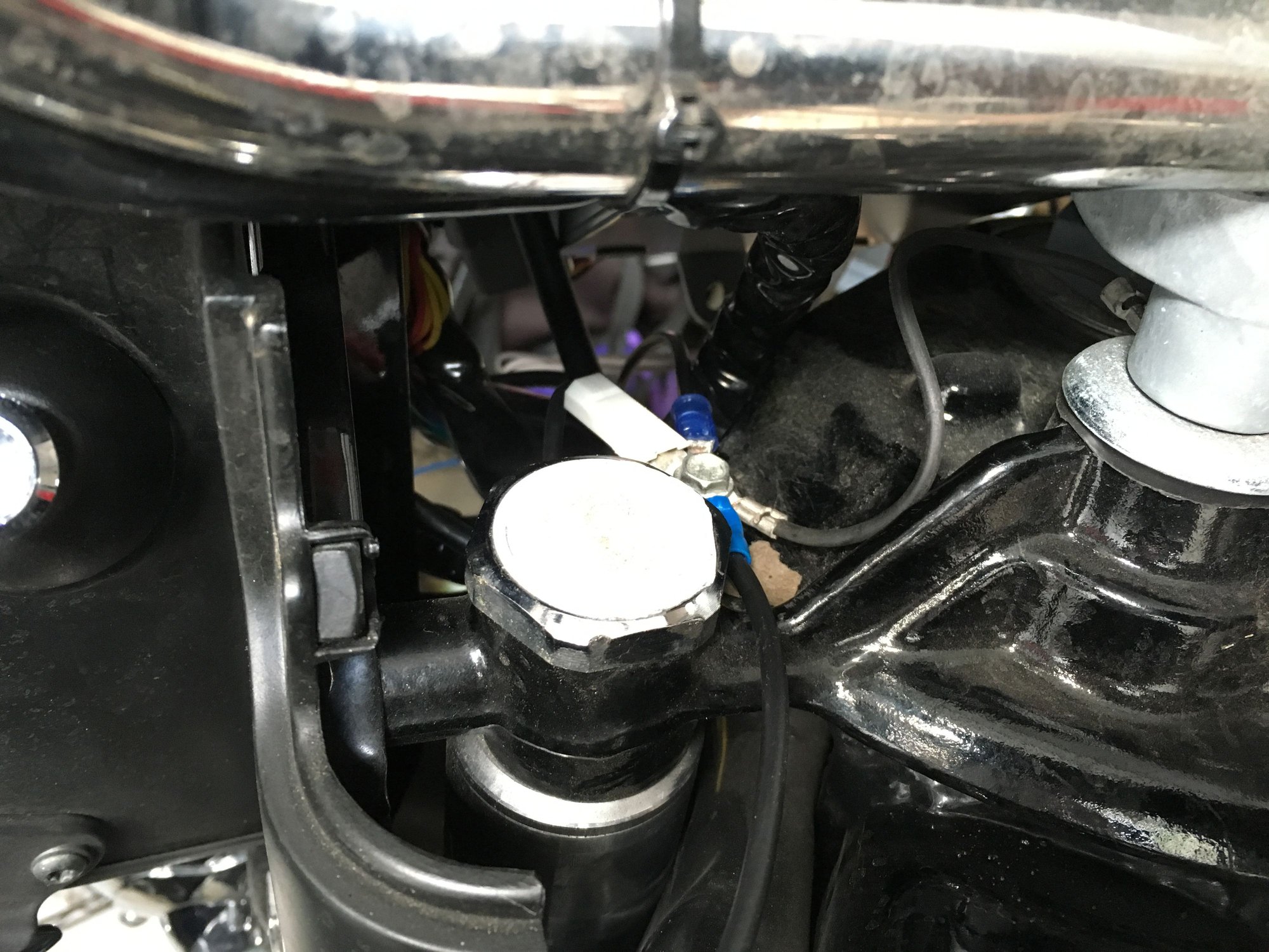

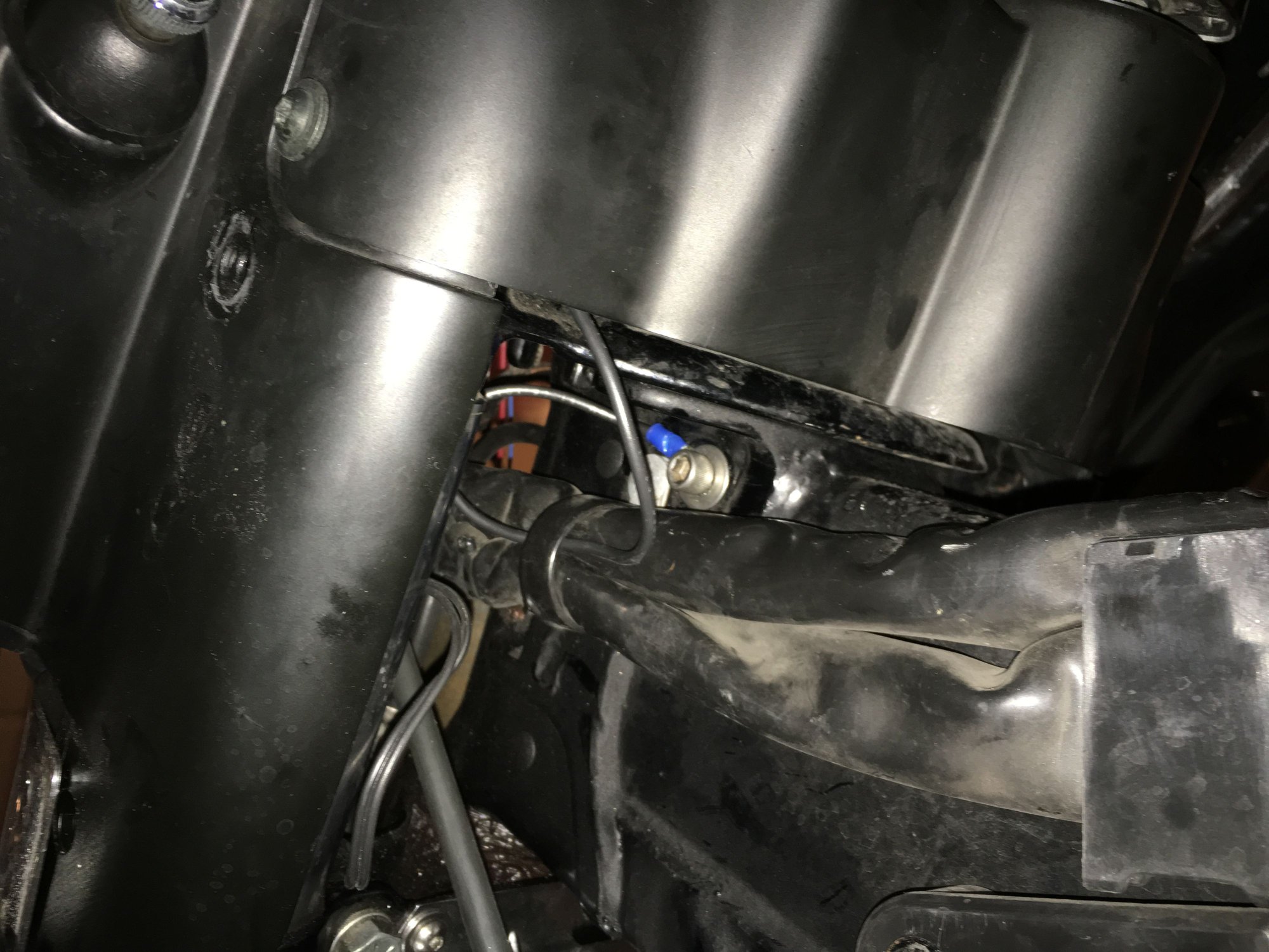

This is the way I ended up doing it. I grounded to the point on the triple tree and then ran a short ground jumper to the frame.
Bates - I realized the wires from the amp could be removed so yes I agree one single strand if running to the battery.
Triple tree grounding point. Existing were the radio ground and jumper to the area behind where the bars are mounted The items I installed were the amp ground and 14 gauge jumper to frame,
Pre-existing hole I taped for a 5/16x18 screw.
Ground secured.
