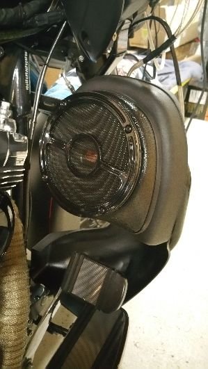

Originally Posted by Greatsteaks
Most people go with the HD cvo grills. Do a search and you will find the part numbers. The install is quite easy so if you choose to put the glive boxes in first then swap them with pods it's not that hard. I went with the $71 ebay pods that came in vivid(gloss) black already painted that matches my bike. I would recommend them as they are much cheaper and one piece but keep in mind I have no experience with the HD pods to compare them to.
Attachment 469674Attachment 469673

Originally Posted by Sturgis67
I like the looks of these, any chance you remember the seller you bought them from? I need to invest in a pair.
Thanks!
https://www.ebay.com/itm/331770853944
