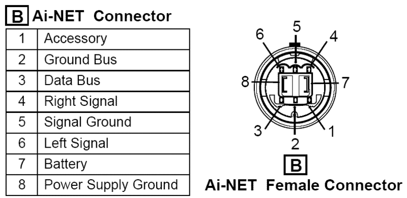

I have an older alpine deck (CDA-9885) with the old AI-NET plug in the back (used for the old CD changers, remember those) I have got an AI-net cord with RCA in (female) plugs on the end so I can add a JL audio Bluetooth unit to it, but, what I would really like to do is find out if there is something along the lines of a "digital" music changer that I could plug into this port to use a USB thumb drive as the "changer"?

then of course if you get desperate, you could always create your own with a little imagination and about $30 in parts.

Thanks for all of the information UN! Once again you come through on the difficult questions. I'm intrigued by your final statement. What do you figure it would take to create this? I have an AI-Net plug already that I can use.

to be honest, even with my experience I wouldn't fool with it. One wrong touch of a soldering iron or wire and you've not only toasted whatever cable you've connected but likely the entire AI-NET internals. Too many readily accessible products on the market for a little-of-nothing to deal with the headaches of this.
