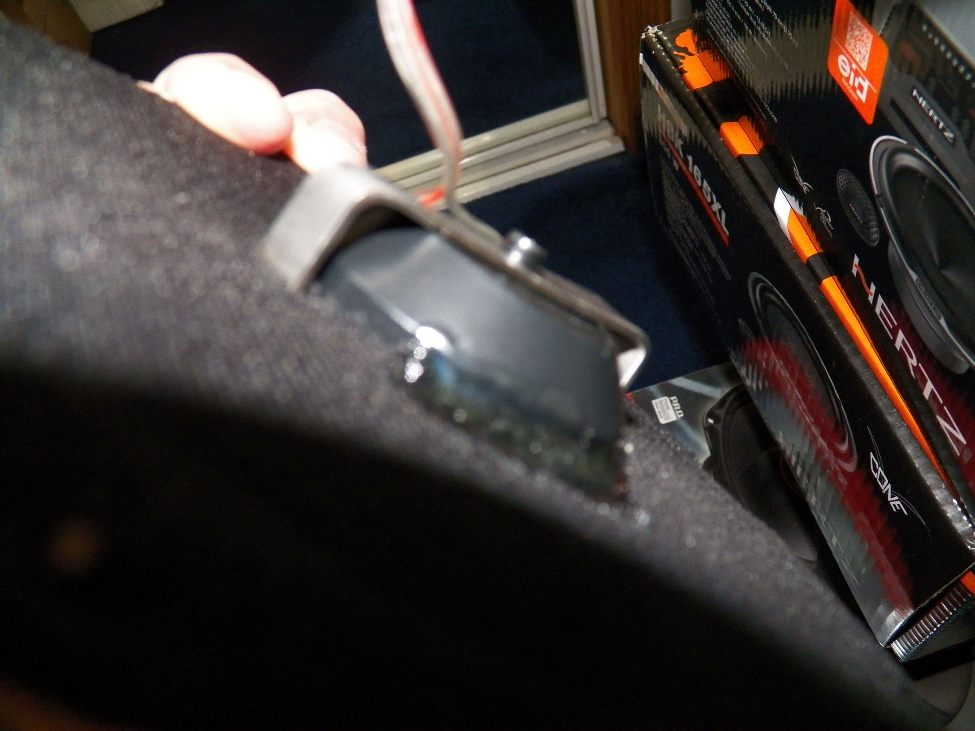

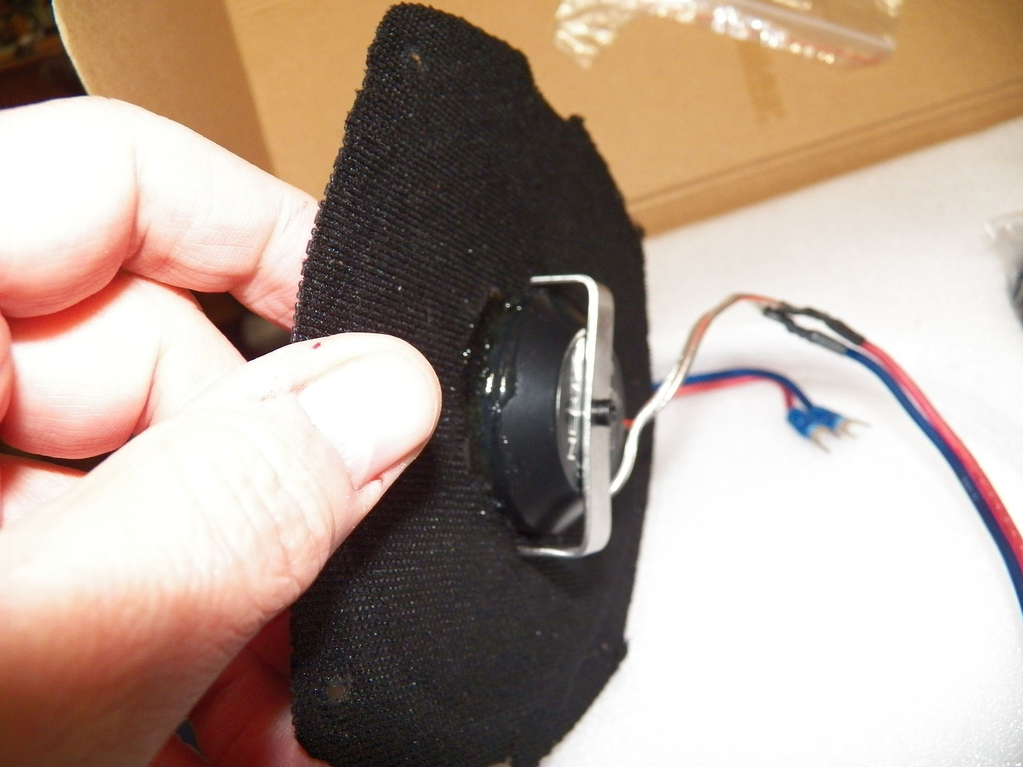

Nice install. Here is a tip for the tweeters. I know haze was exploring options to get a better mounting bracket. Go buy some 22g sheet metal from lowes or somewhere, cut a strip about 1/2" wide. Drill a center hole, mount screw and metal to tweeter( not in grill). Bend 2 90's at the edge of the tweeter leaving a tad bit of room 1/16" or so and then trim flush with face of tweeter adding about a 1/16 of an inch again to that depth. This will give you a solid mounting point without the need for any adhesive. If you do still feel the need, use a tad bit of clear epoxy weld on top and bottom. A dab will do.
slyedog, by chance do you have a pic of this method of install?

I can't find any. If makdaddy is in the position to do so, he has the set I did this exact method to, and may be able to provide a picture if he hasn't installed them yet. If I do find a pic buried in my pc somewhere I will.

Here are a few pics I had sent to me. The epoxy is optional. Using jb clear weld it will help a tad and will pop with a little force. Try without first and go from there.
Thanks! This helped me a lot.
