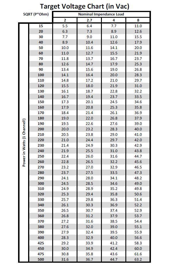

JL's recommended setting of 23.7 VAC is based on the formula we all use: The square root of (watts x ohms), which in the case of the MHX is the square root of (140 x 4) = 23.66 VAC.
This amp is "under-rated" and can be pushed a little harder, say 25 to 25.5 VAC without any ill affects. I think Tailwind was running his much higher when it vaporized. LOL
You have a DMM, so use it. Don't worry about the gains being set at half-passed eleven or other such "visual" settings. The pots from one amp to another can vary by one or two hours (clock reference).

I ran my 280/4 at about 26.5 volts (175ish watts) to a set of M770's without issue. I actually had a local shop set up the amp initially and they had it pushing 27 volts but I backed it down a tad just to be safe
The Moto 602's like power and I think sound better with 150+, I'm running a TM400x2 to a set of 602's right now and love the sound.
I'd start at between 25 and 25.5 to the 602's and move up WITH THE BIKE RUNNING.
If you want to play it safe, don't go past 26.1 volts (I had a clean signal a tad over 27 volts, yeah I checked ) but if you don't have a way to check if the signal is clean or not (o-scope or DD-1 etc) then probably best to stay below 25.3 just to be safe.
