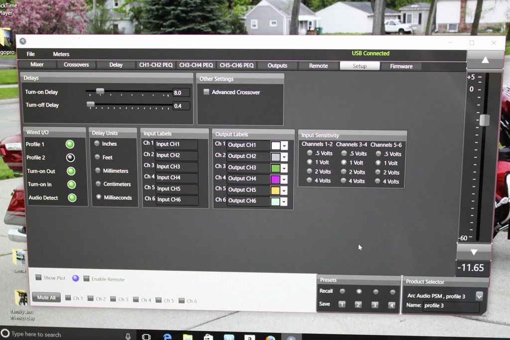

my PSM is set up for profile (1) but it shows a different preset on the software, anyone seen this before ????
just recall preset 1. I encourage any install to not wire the preset and manually select it in the software. This allows you to utilize the different presets without it defaulting back to the wired preset when power cycled.
