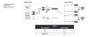

Next question, what is my target voltage? Attached is how I intend to wire the amp, which is considered 2 Bridged Mono Outputs and says the RMS Power will be 250W x 2 @ 4 ohms. My questions is, is that 4 omhs or bridged to 4 ohms on the voltage chart?
Any help would be greatly appreciated.
