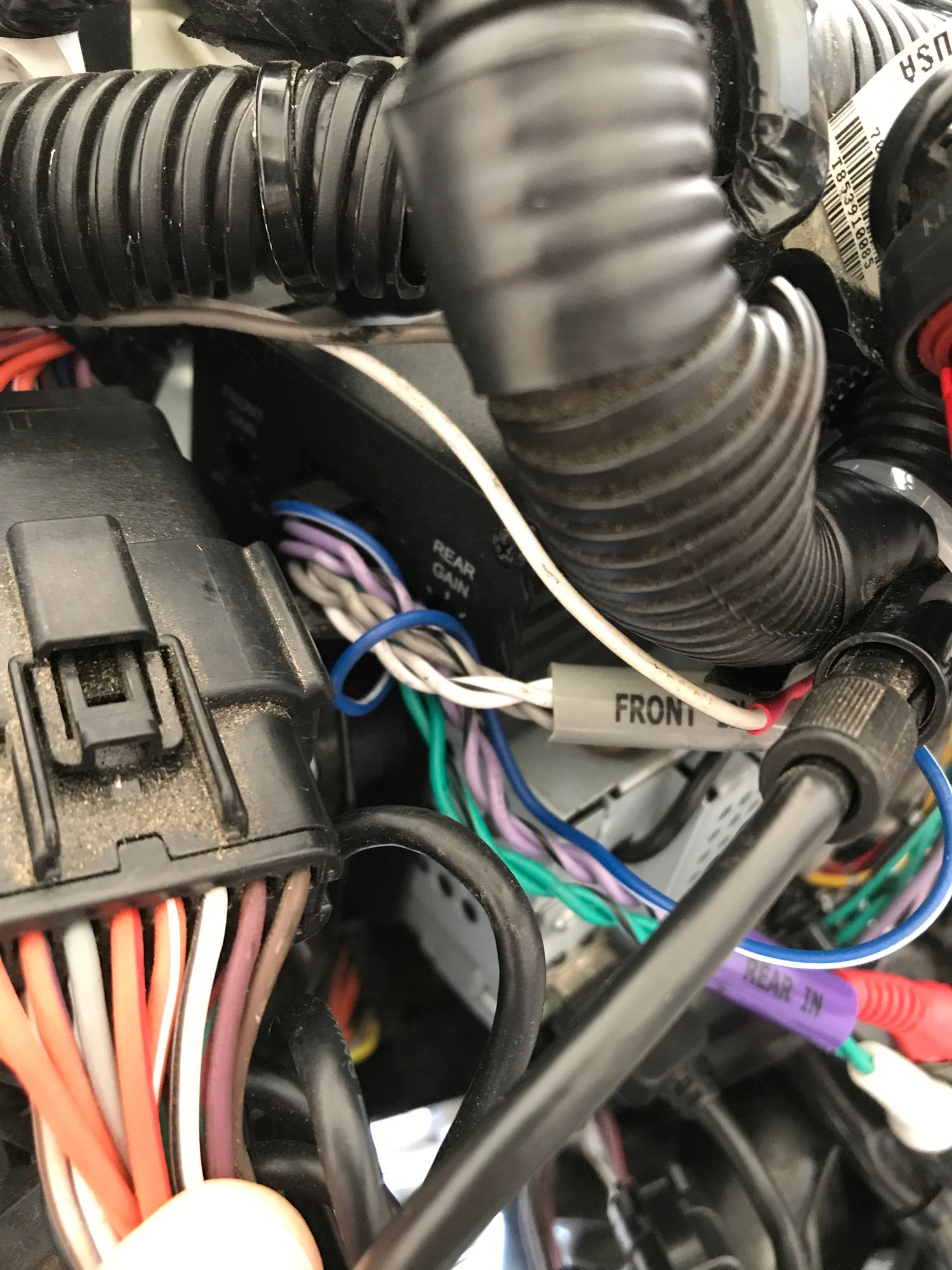

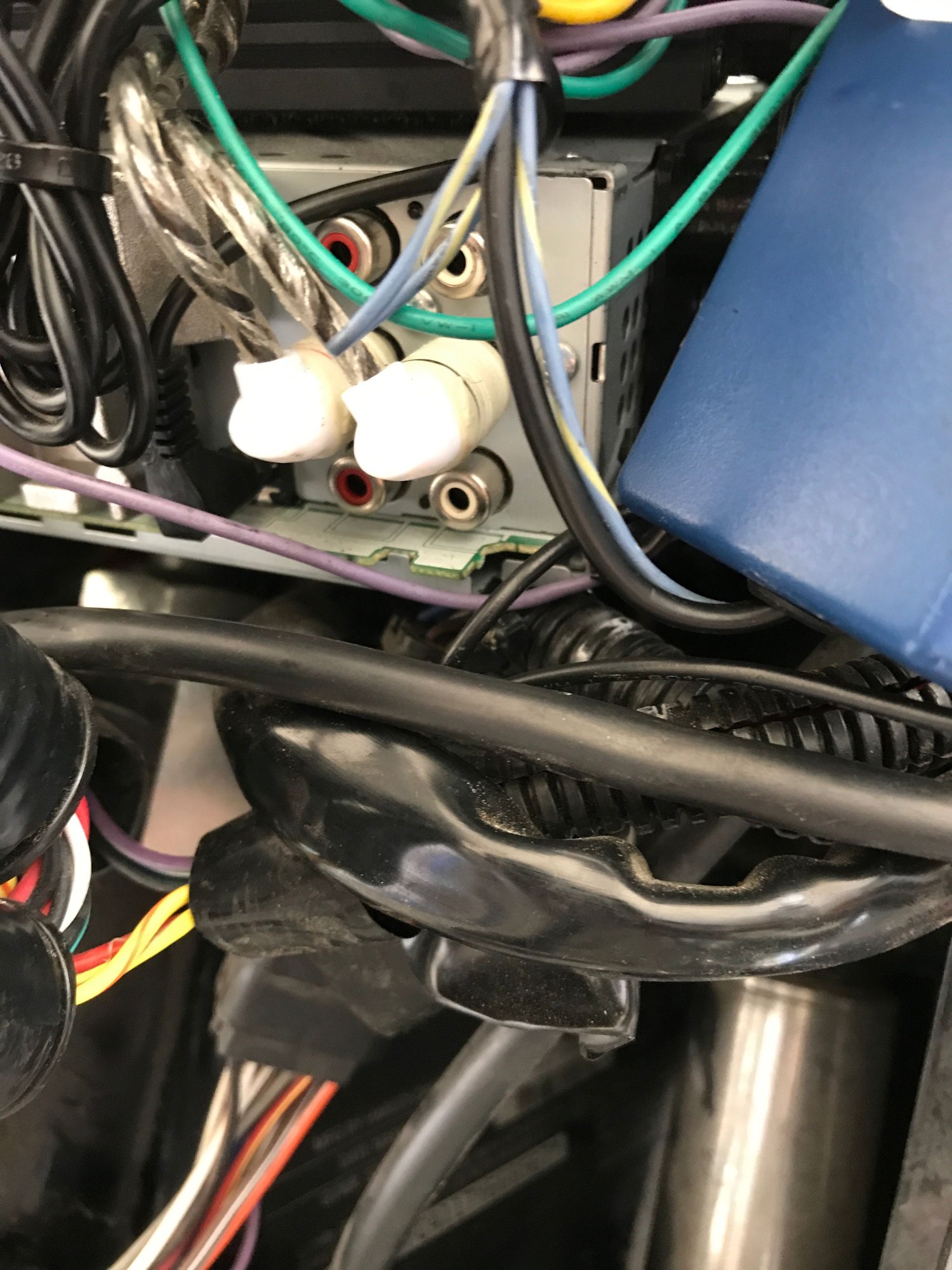

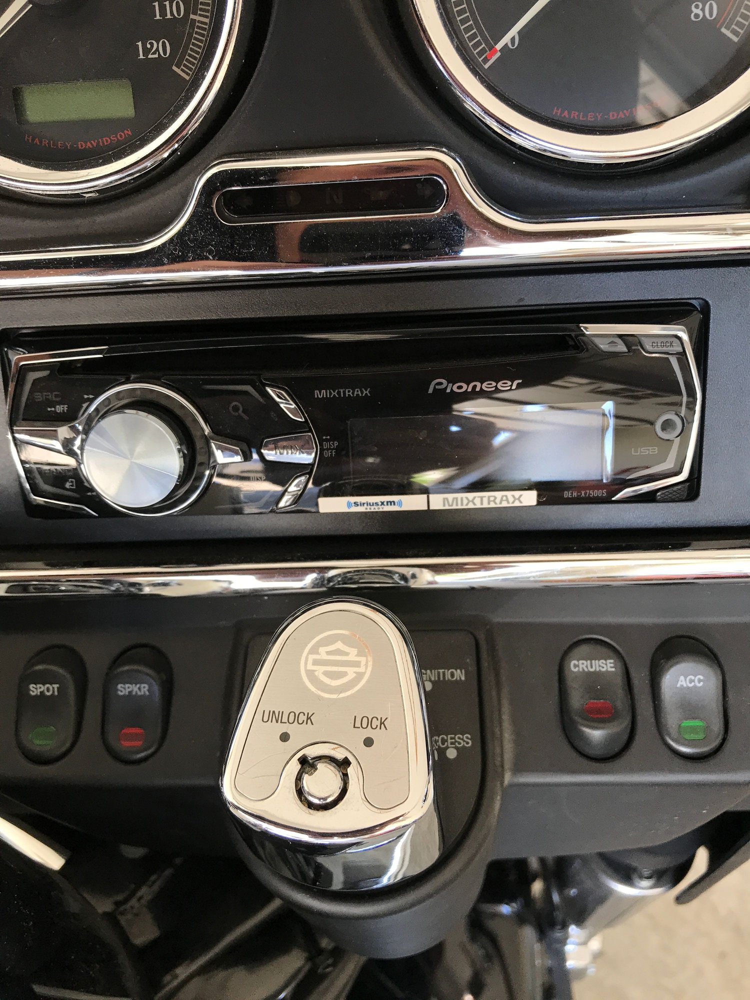

-The HU is a Pioneer MixTrax DEH-X7500S
-The Amp is an Alpine Head Unit Power PAck KTP-445U

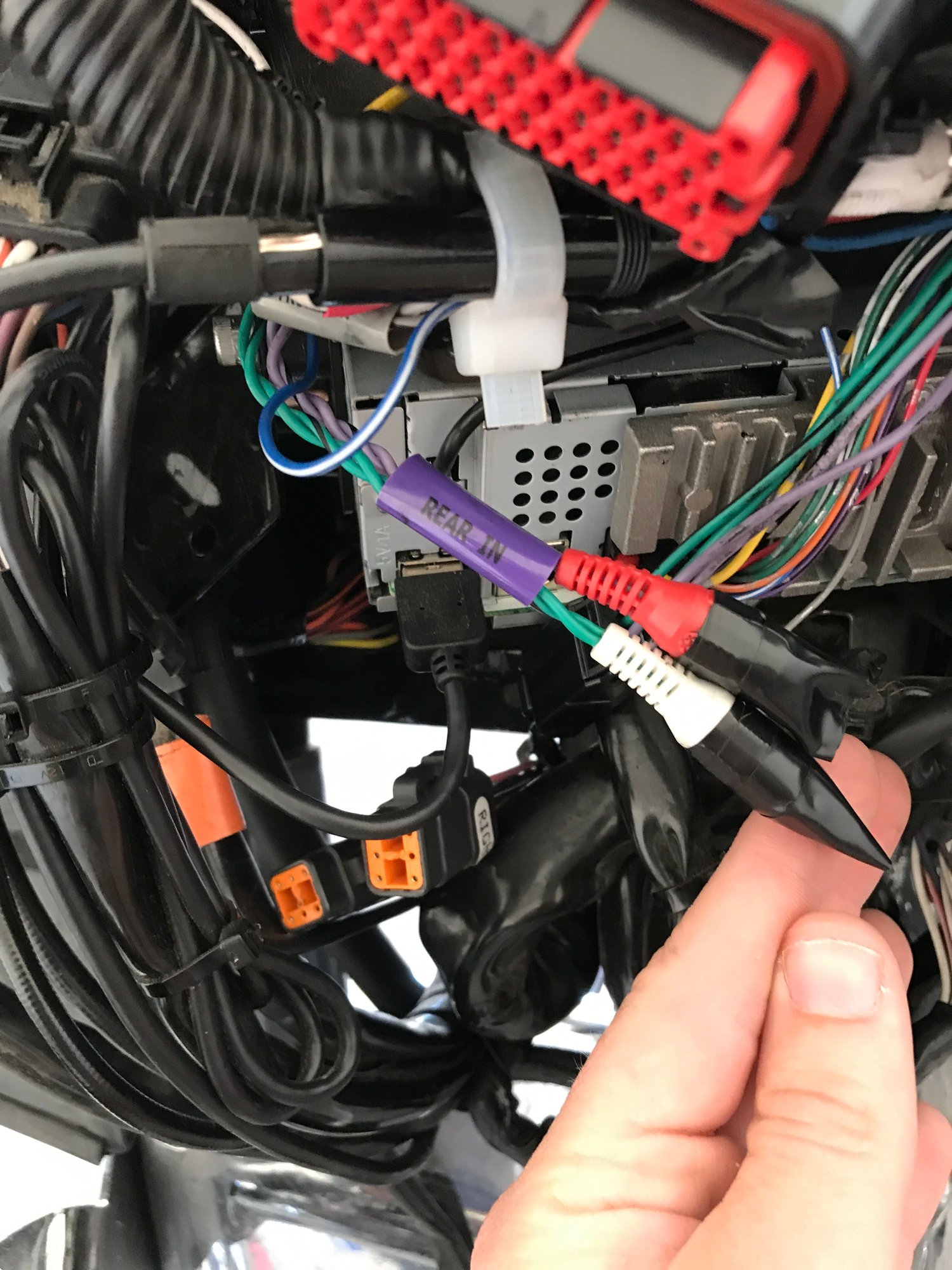

-The RCA cables labeled REAR IN are currently disconnected with electrical tape. They are connected to the Amp.
-When I connect the RCA cables to the back of the HU, they do nothing.
I hope that helps narrate the pictures.
HU- Pioneer Mixtrax
RCA Cables, currently not connected
REAR IN RCA cables connected to Amp
Currently the FRONT IN cables are connected to the HU, which controls the Front Speakers and the Lid Speakers. When I plug the REAR IN cables here, nothing happens.

If you look at the pic of the Red/White RCA cables, you an see that there are Orange plugs that read RIGHT and LEFT. They are not plugged into anything, and I assume they need to be. The problem is that there is no Male end to plug them in to. Whatever goes opposite of this plug seems to be missing.

First and foremost you gotta lose that amp brother! If he's got that amp running 4 speakers they are only getting 45 watts per speaker. Both sets of speakers are running on the front channels. The tour pak speakers are not hooked up to the amp for the rear channels. Again, The Alpine amp is a good amp for what it is But IMO has no place on a motorcycle! Just slightly better than stock. What 6 speakers are you running?
