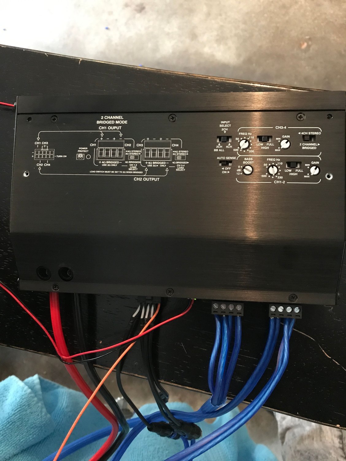

using an arc moto 600.4
got everything hooked up, only thing not connected is the orange wire for the remote turn on
I have the auto sense turned on
I have voltage to the amp, checked with DMM
any ideas?

Hook up the orange wire and see what happens. If it turns on, then there is an issue with the auto sense.

sometimes the RCA input from a converter just isn't enough juice to turn it on. Use the remote turn on and shoot me a note with how it sounds!

Thanks guys for the feedback, I figured this might be the case. I ordered the other kit from Arc last night for the remote connector (that's an expensive way of not cutting wires lol). It will be a couple of days, but when it gets in and I sort it out I will follow up with performance feedback

Resolved the issue and found a $2 solution at the dealership, seriously lol

here it is when first turned on, with the gains flat.

This is where I ended up with gains. Unless someone has a reasonable objection, I'm buttoning it up lol
