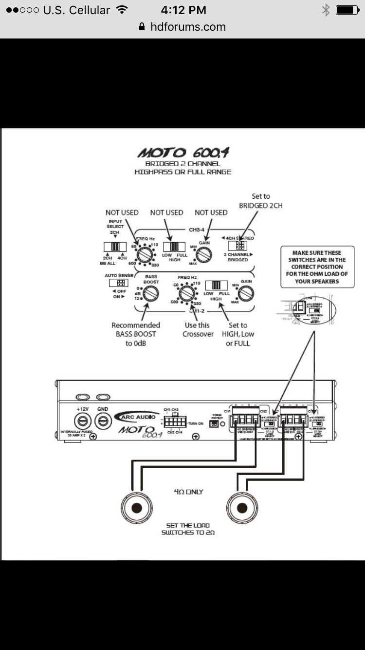

trying to finish up my install. Right now have pretty much everything installed. can I run my arc 600.4 bridged and setup like in the picture? Speakers are DD aw6 and at 28 fairing only.

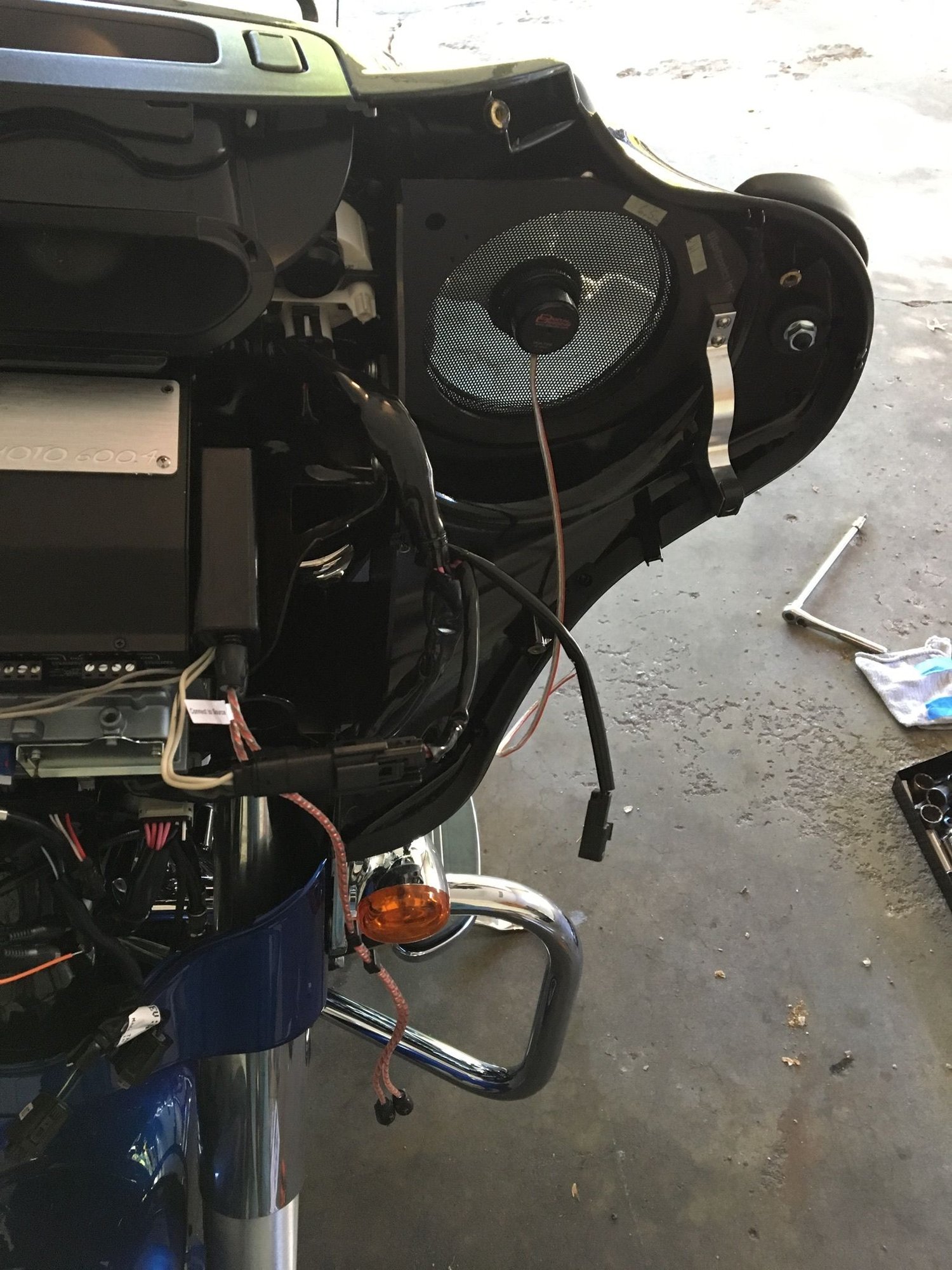

Next I purchased the auxiliary power harness but not exactly sure if it plugs in the next picture and from there how it hooks to the remote turn on. I was under the impression that would keep from cutting any stock wires. Thanks for any help.

The remote wire connects to the orange wire on the amp. There is a plug on the left hand side of your above your radio if you are standing in front of the bike where you aux plug goes.
You can run the amp bridged but I STRONGLY recommend tuning the amp with a Digital Multi Meter and 1000hz test tone and give those speakers no more than 200w (around 28.5vac), otherwise you may cook the tweeters if you give them more juice than that.

I think I found the plug you are talking about. But is it supposed to work when it's in both ignition and accessory? Mine only works in ignition.

The wire you need to look for to use for the remote is located in the circled area.
It is the plug with the blue wire coming out of it.

Found it. Thank you.
