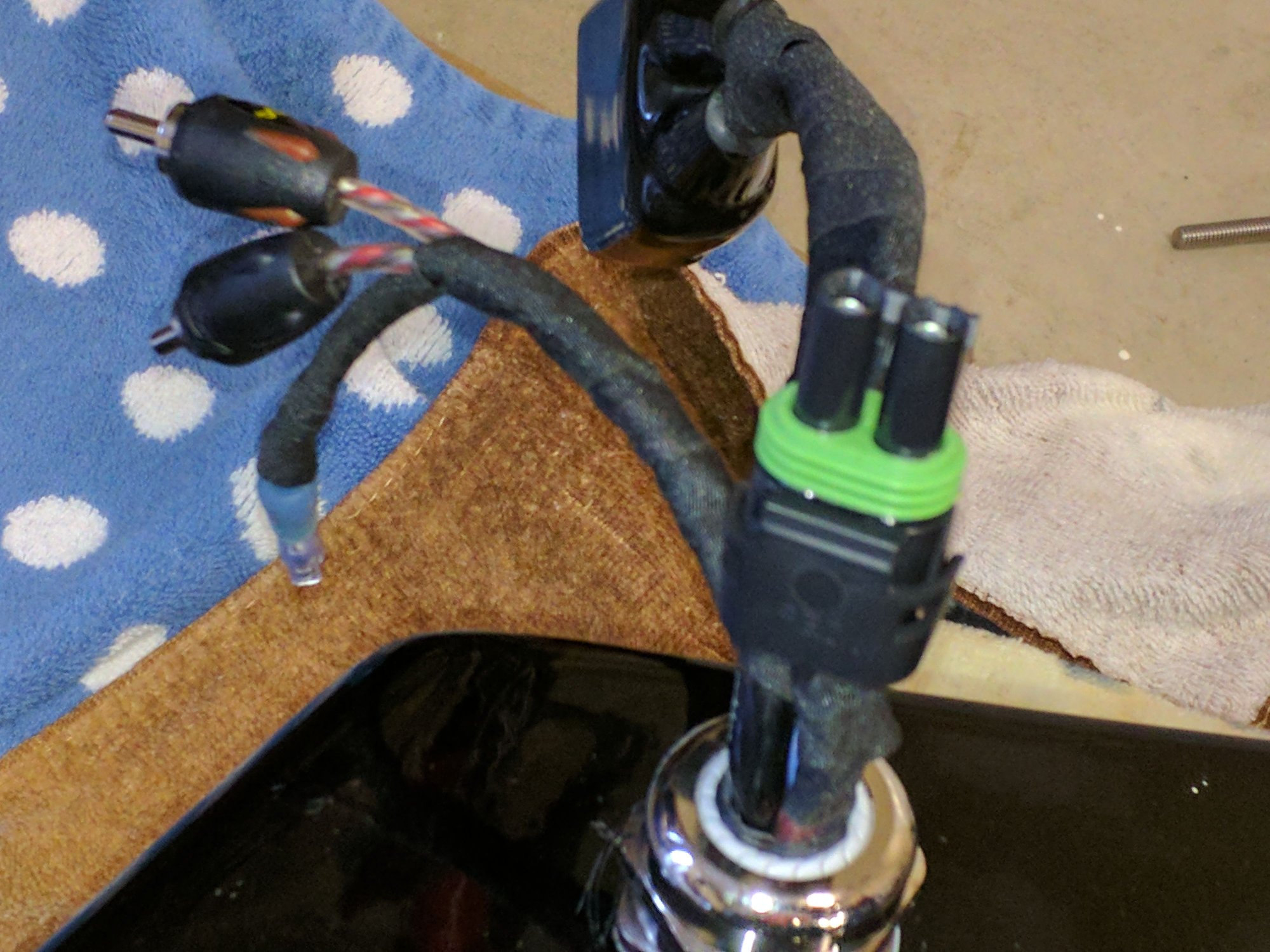

DD D4 worked for me.

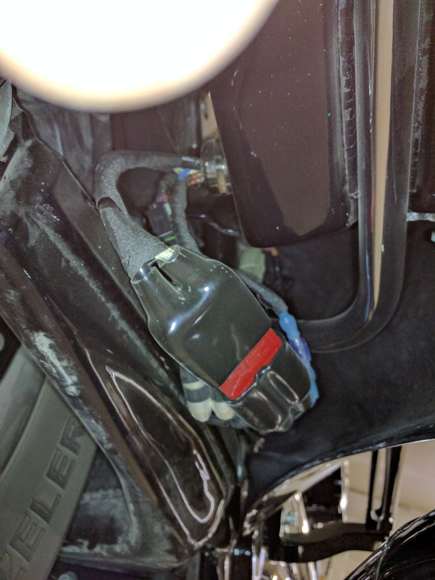

D4, older version of the D4.90
Slye did a lot neater job than i with the quick disconnects. He helped me a lot when i was doing mine.

I'm going to assume that the two blue wires(closest to your hand) with the red tips are the speaker wires, the power and ground are connected to the anderson connector, and the rca cables are the ones furthest to the right wrapped in the black material. Do I need to add an additional fuse? Can I connect the remote wire to the same place(cigarette lighter) as my first amp?
Thanks,
Brian
Those wires closet to my hand are remote wires. I have my remotes daisy chained from the cigg lighter to amp to amp to amp.
One fuse per amp
And yes, the wires in the back are the RCAs

Oh, my bad. I just realized that the speaker wires stay in the bag.
Old Nov 10, 2017 | 09:47 PM
sponger's Avatar
sponger
Joined: Sep 2015
Posts: 1,168
Likes: 79
From: so cal
They do, except for the ones that have to go to the other bag
