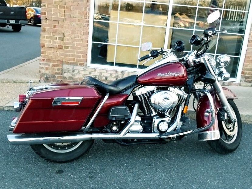

What color is your bike?
Old Apr 12, 2018 | 07:29 PM
SoloRider67's Avatar
SoloRider67
Joined: May 2016
Posts: 32
From: Leesburg, VA
The official color is called Luxury Rich Red.
