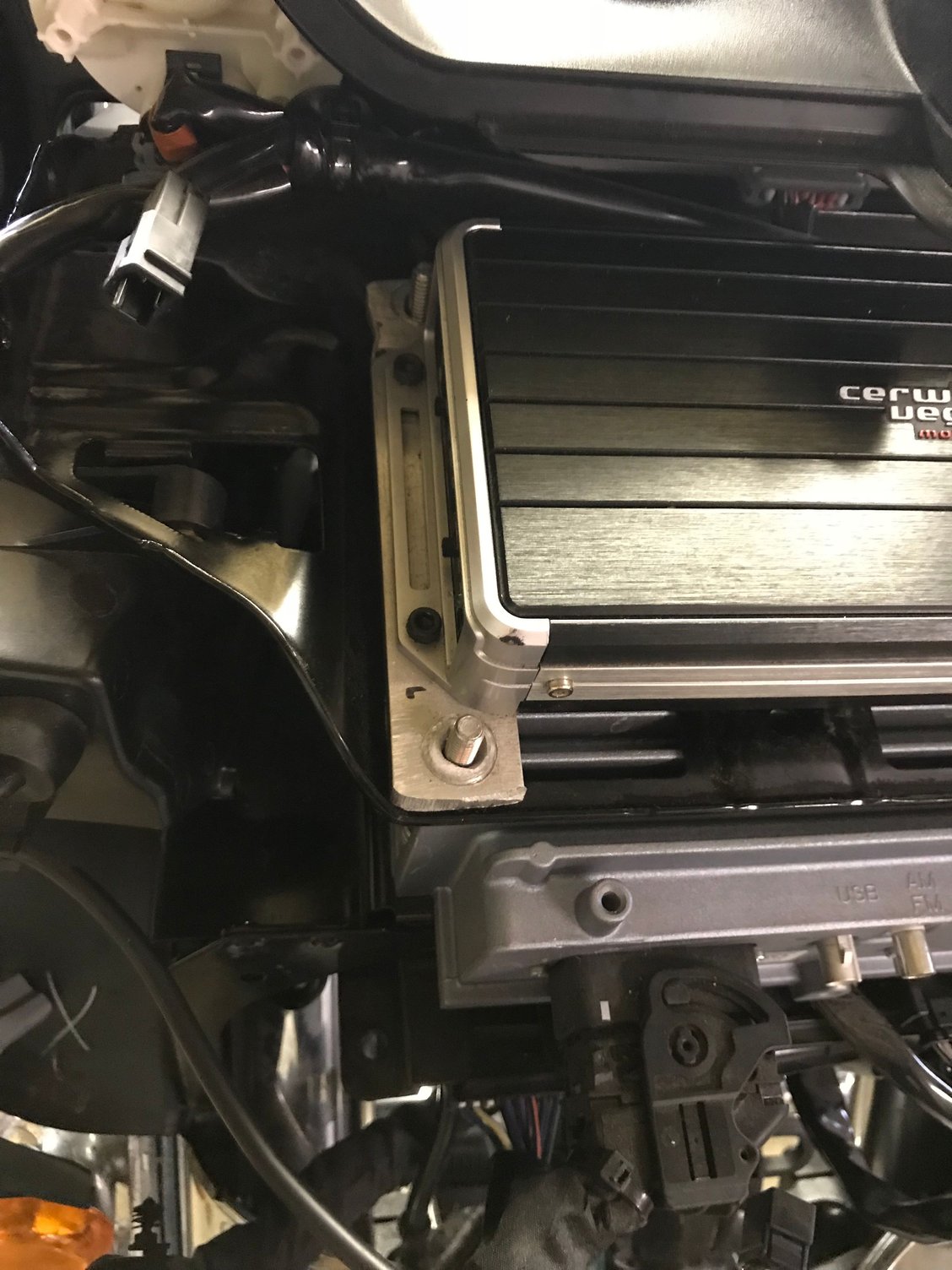

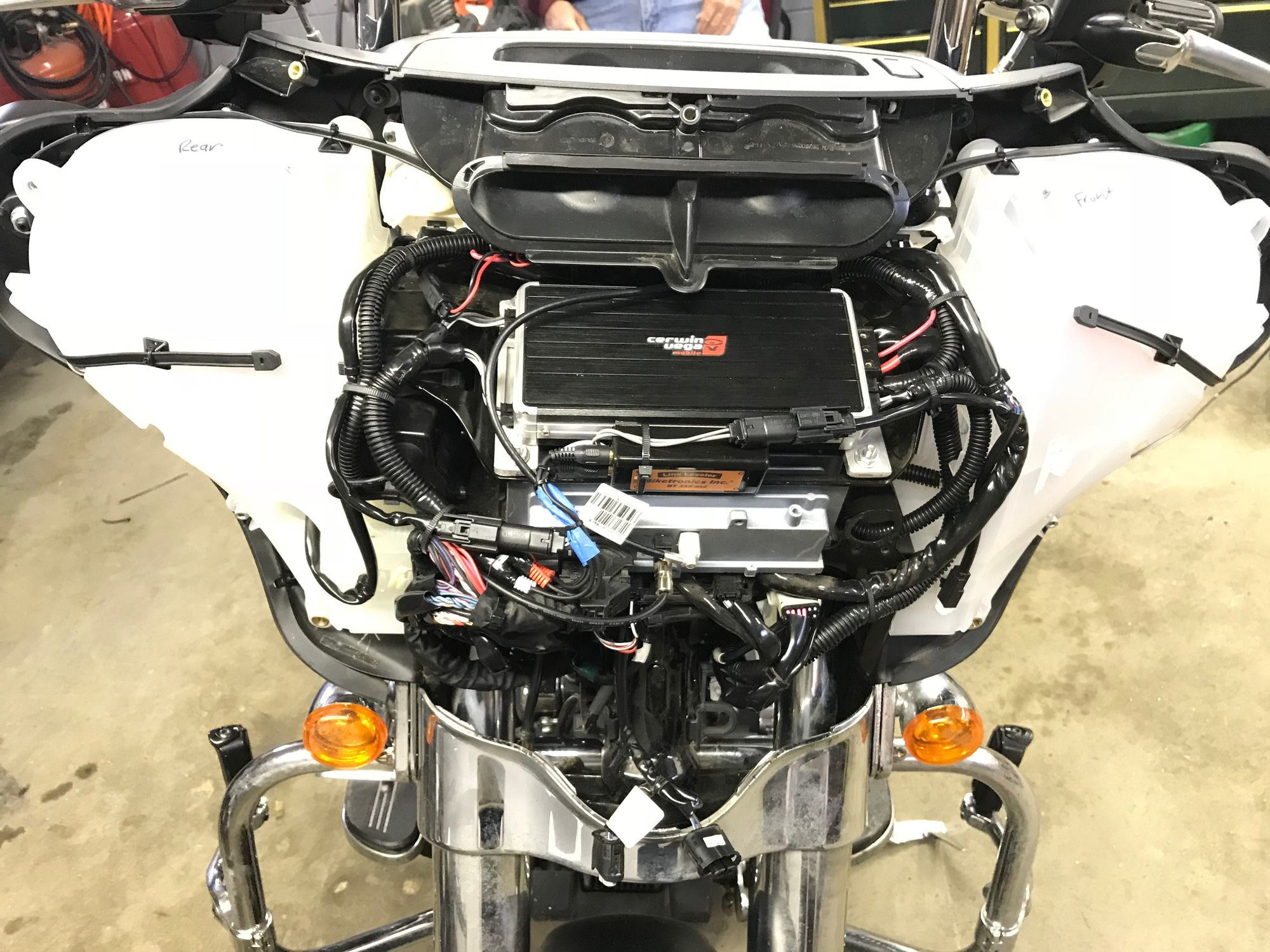

Many people just use Velcro and zip ties to mount their amps, and that works fine. I try to rigid mount electronics when possible. Here’s a few pics of how I mounted a B54 in mine.
First I installed 1/4 bolts in factory holes in the tray. Then cut strips of 1/4x1” aluminum. Then mounted the amp to that. Amp is solid and allows air flow around it for cooling.
