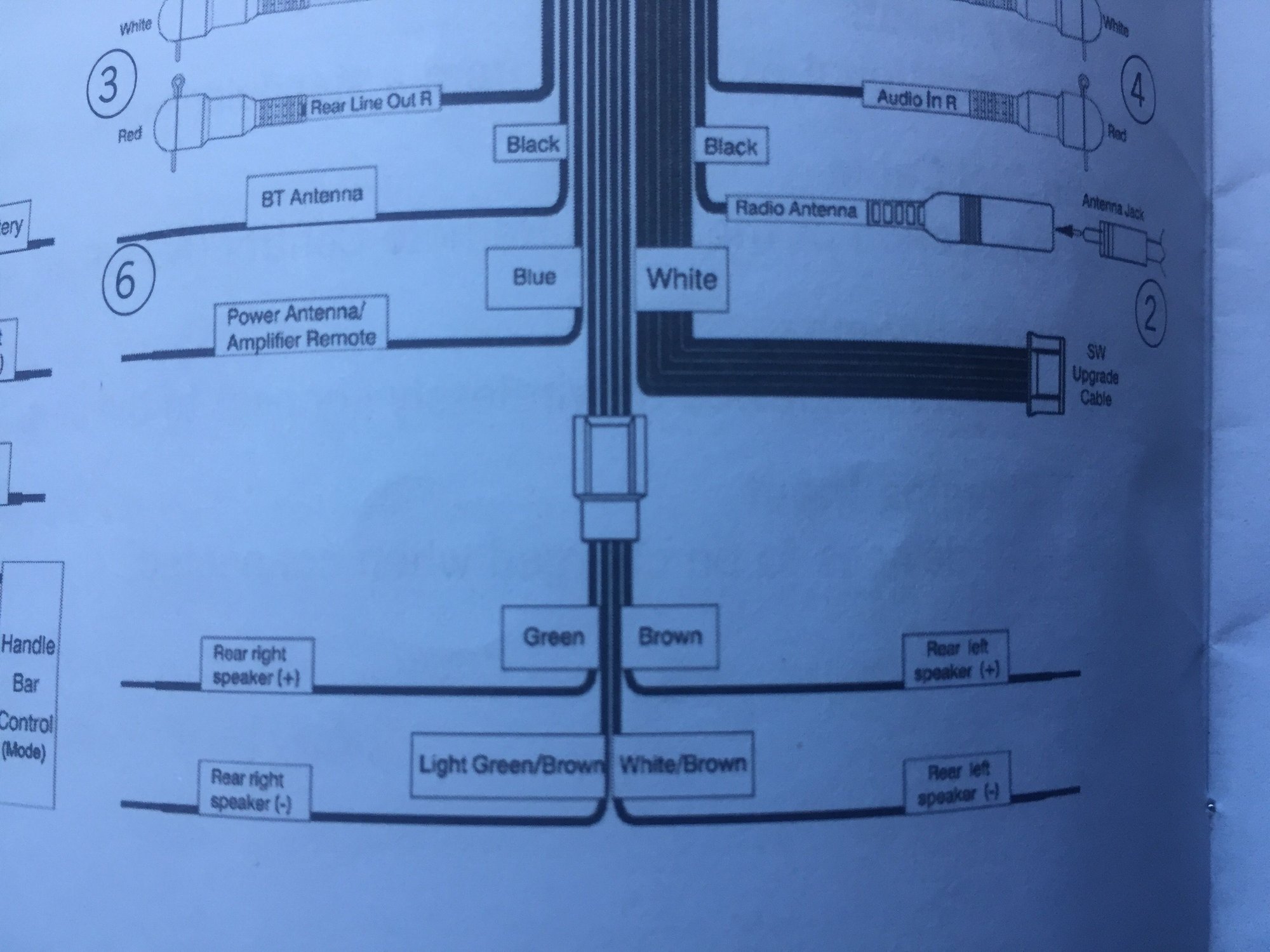

Last night I installed an Aquatic AQ-MP-5BT-H it went fine. I turned it on and worked great on fm but when I tried Bluetooth the front right speaker stopped working-- it still had the beeping for sound and station changing just no music on Bluetooth?? The other tree speakers worked fine. Btw it was install on an 08 ultra. Tried three different phones with same results?? Again everything works on fm it's just Bluetooth which I listen to 99% of the time. Any ideas? Crutchfield was stumped, and out of stock on a replacement. This unit uses the harley plugs so splicing was not an issue. Thanks in advance.

That HU only has left and right speaker outs. How did you configure the 4 speaker setup?

It has a plug for rear speakers included. I had to find the rear speaker wires in the 35 pin plug that you don't use.
