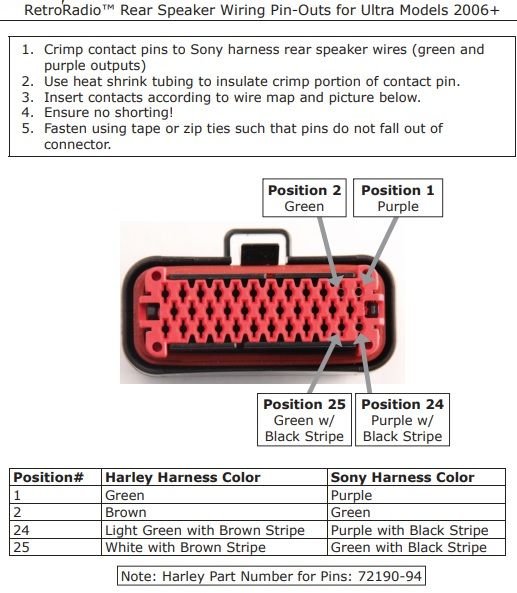

All of their radios are 4 channels but the rear channels are only active on the Ultras. You would need the dealer to activate the rears on your SG and you would need the pin out numbers to tie into it.
