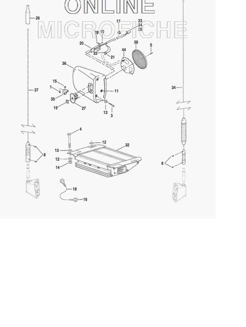

If I remember right, 08 cvo's don't run any amps and 5.25 speakers all around. To change speakers only wont do you justice as you wont be able to hear it at speed. I will bet that is the problem now. You will need an amp and you can upgrade to 6.5 speakers to make the difference.

Is that amp under the tour pak. Juice

With that stock amp on the CVO, you are kinda limited to 2 ohm speakers. If you plan on staying with the stock deck and amp configuration you can go with the Kappa's.
Are there better options sure but that will require more money/time/ and better amp/deck.

Thanks Juice as I couldn't remember if an amp was in play or not.

thanks for the suggestion yes the amp is under the tour pack. the speakers are loud enough just sound like crap.
