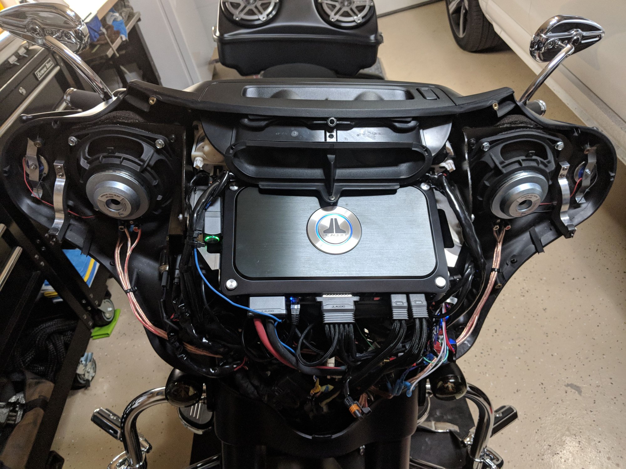

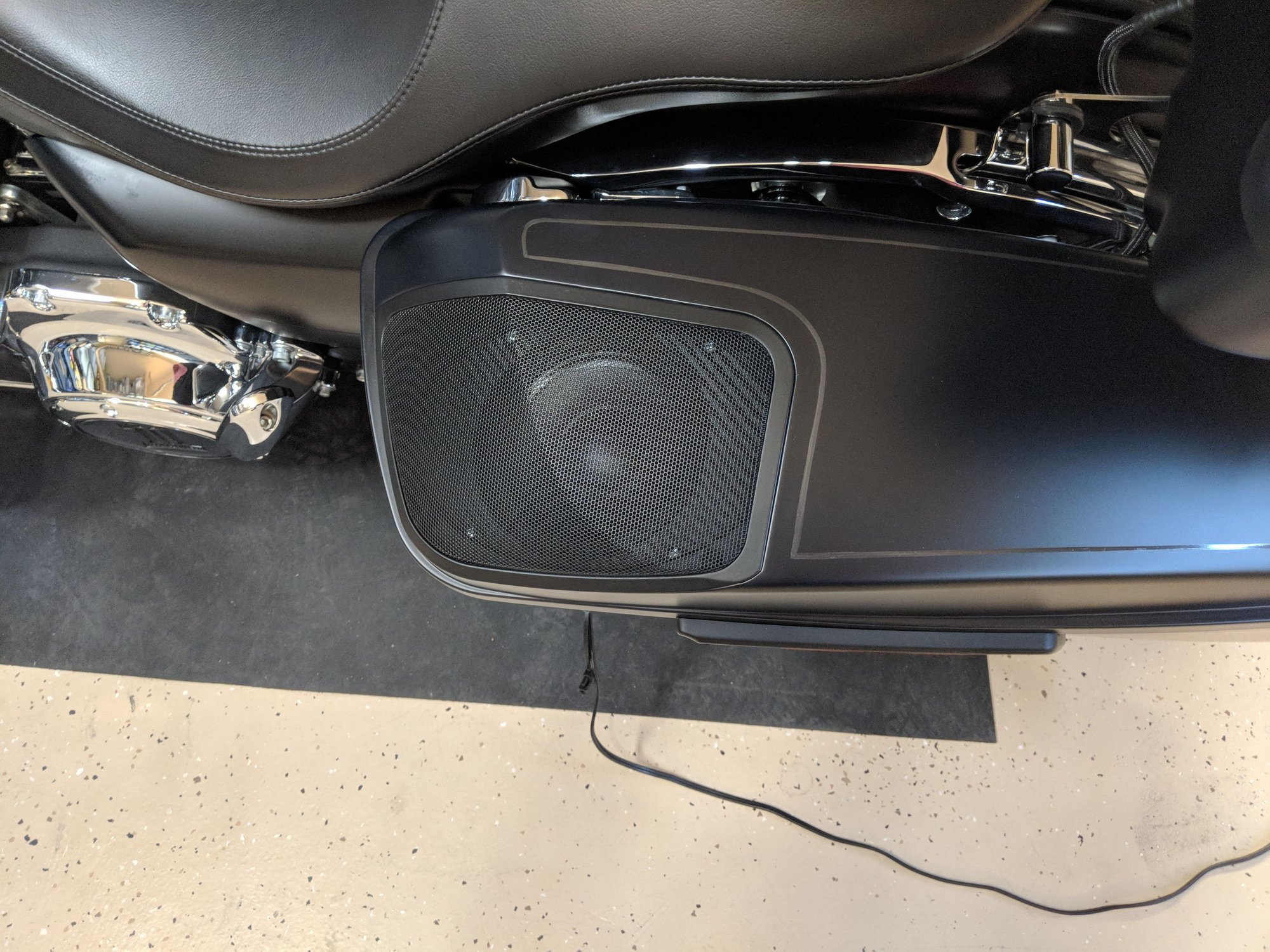

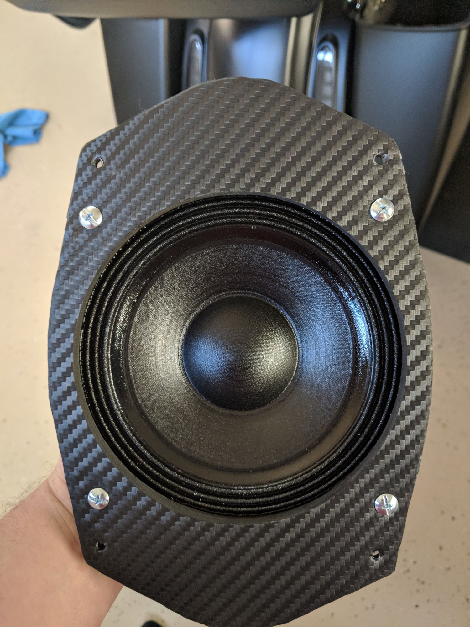

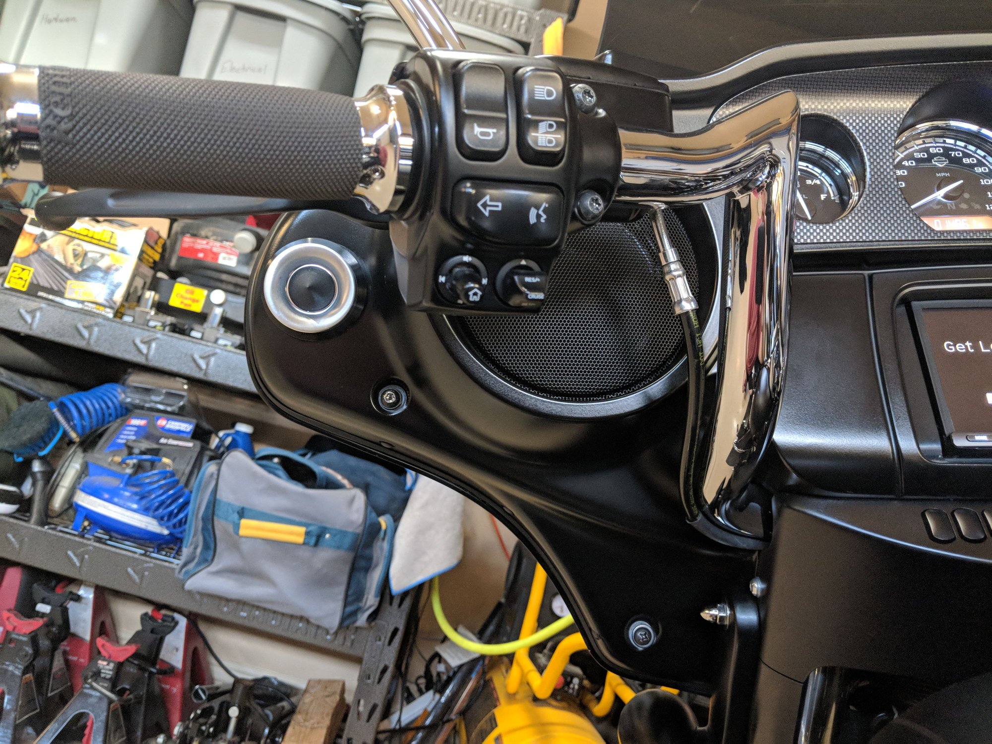

I installed the Faital Pro 6PR160 this week and man these things rock! I'm still tuning them and breaking them in, but very impressed so far. The sound quality is top notch and very precise in a very small and light speaker. I had the PR122s in the fairing and lids before and very impressed with Faital Pro series so far. I'm running them off a JL amp and DSP and it doesn't take too much power to make these sing.

Hey Mike, I would say they are loud, clear and precise. The frequency range is supposed to be from 80-8K, but I have them crossed at 10K and they sound awesome! They only have a couple hours of play time and the mid bass is improving as they break in. The 8 ohm is so I can still bridge my amp while pairing them front and rear left and front and rear right to keep stereo sound.

I dig the brackets also.
