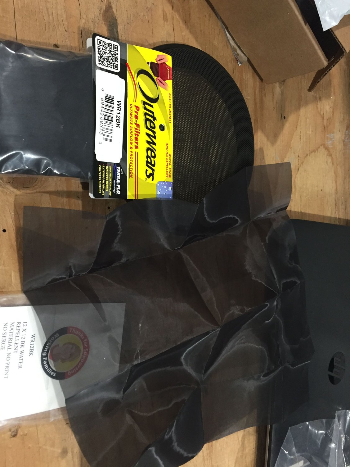

Default Waterproofing membrane?
I can not recall who turned me on to this product in a past post? I believe it was Gypse. I would like to know what anyone else has done for application? I’m thinking 3M adhesive spray? Also how did anyone get the creases out of the material? Thanks!

I ironed out the wrinkles,and it did not seem to affect its water resistance. i jut cut mine to fit the grills on the front and glued them in, on the rear a little glue and then sandwiched it
in between the lid and cone.

Thanks Mike
I was thinking the same thing as far as the iron but did not try it, mostly because I’m not sure where the Mrs. keeps it. I used a heat gun and got them pretty smooth. I will say don’t get distracted or it will distort quickly even on a low heat setting.

Silicone will shrink when it dries and that tends to pull it taut. Lay a thin bead and watch the magic happen. I use frogskin.

How did you do this? I tried it and was moving all over the place what is a complete mess

I did not use silicone. I placed the membrane inside the grill using a light coat of Scotch 77(?) spray adhesive. Only had two holes close up, hardly noticeable.
