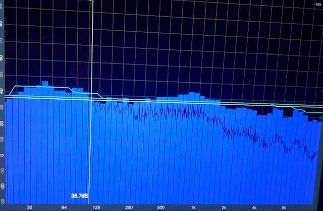

What your trying to find out?? Are you looking for a target EQ like this once it's graphed showing what's actually playing with 45hz as the peek frequency (this is a LW bike BTW...not subs!)
Or do you just want to see some random EQ's? I have TONS of these but don't think they will offer much help.
Yes your EQ previously was very bad, but showing a random EQ is not going to help you much either. There should be more posts encouraging folks to LEARN how to EQ and learn how things work vs. just tell me what you did so I can copy it. NO ONE here competes or does this for money so I don't get the reluctancy.
Hope these pics help.
thanks and I’m not looking for anyone’s specific tune just was looking for a what a generic
eq graph should look like. Should it look like a smile a frown a bunch of mountains. If that makes sense?

Since you are tuning each speaker separately I would say toss out an idea of a generic shape of your EQ -- Each speaker will look different (since they are all doing different things/playing different freqs).
