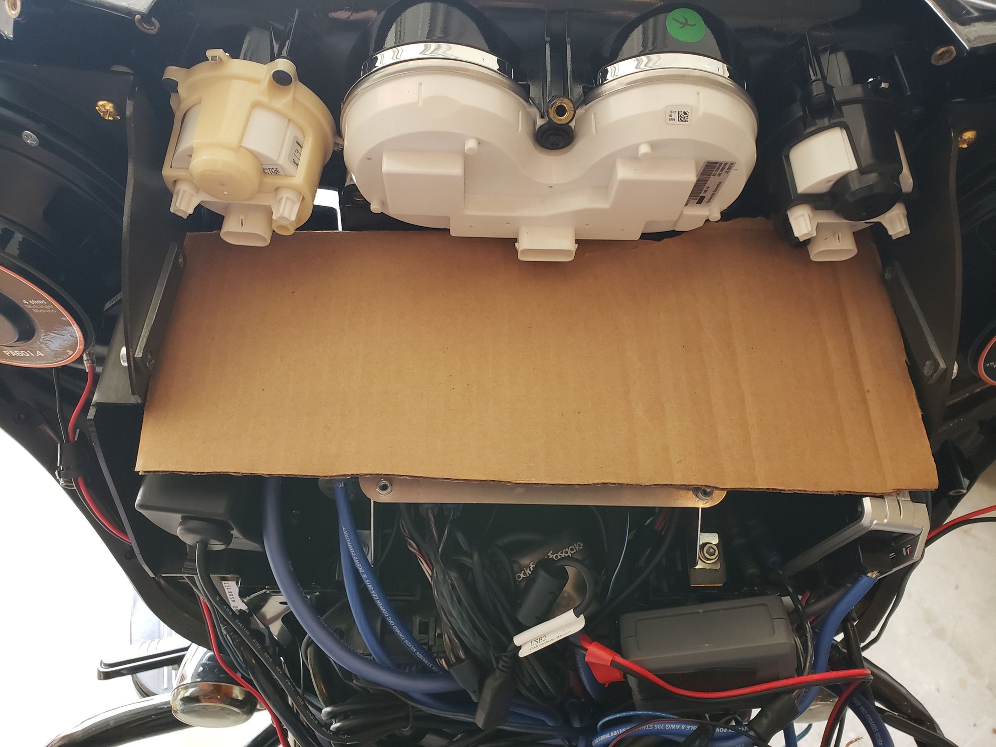

No, and I intended to. I bought a cheap mount off eBay for $40, and it fit great. I actually mocked up a 14" plate (versus the 10" plate I bought) that would be completely flat, and allow it to connect to brackets/pods. Having a mill handy is nice. Once I get one finished, I'll see if anyone in DFW wants to come try it out for free. If I did my measurements right we might be able to cheaply move away from J&M.
Here is my initial cardboard mockup
Ok, how about a the pic of the Amp and all the cables and wires that come with the Amp plz, just want to see what I’m dealing with if and when I buy it.

I just installed a Stinger 700.4. It powers 2 Mmats 601.4s, each on it's own channel. It also powers two 8 ohm Mmats dx35t's bridged on the other two channels. I also have a B52 pushing two DD VO69s in the bags.

Man, what a difference. Not only in sound, but how easy it was tonight the fairing back on. I hate the pigtails, so I used heat shrink crimps to make sure everything stays connected. I'm not tuned quite right, because the neighbors 2 houses down and across the street came over throwing a fit. I guess it was too loud for them. I ended up putting the Mmats dx35t's in the grills, since they take 100 watts. I ended up bridging the two tweeters to make it a 4 ohm load, but I think I have the gains too low. All I need now is maybe some way to cutoff the 5khz and above signal to the 601.4's.
