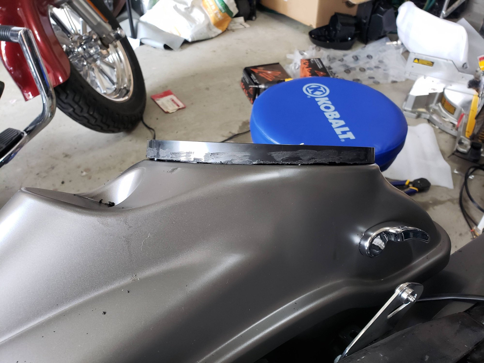

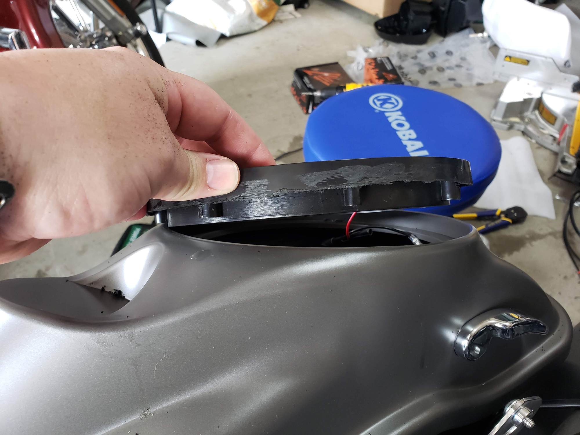

Just curious, what all did you have to do to fit those sv200L in the lids

It's what I referred to as a sandwich fit. You will never get them on sitting flat. You hold them in place and screw them in, as far as the basket will let them go. You'll want silicon around the edge for water protection. The other option is to buy some audiopipe 8.5" 1" speaker rings. Dremel the bottom half of the outside ring. This should give you a flat way to mount the speaker.
