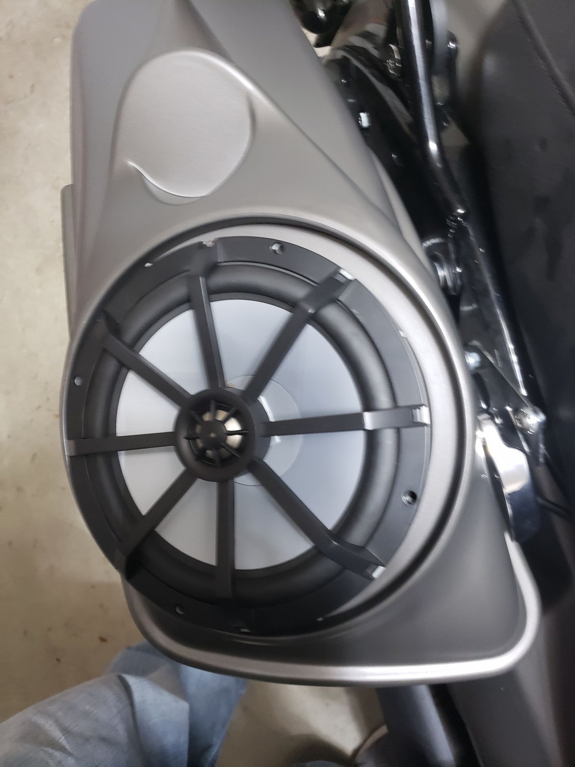

Lids are on, no problem, but the speakers I wanted to try didn't fit. Kicker KM8 boat speakers were too small up top, and the basket was too large to fit next to the latch mechanism. What speakers are working, preferably something with a reasonably low frequency response.

Has anyone tried the JL 8.8s with this. I put a link to their specs. I measured the opening at roughly 8.5".

I’m pretty sure there’s no way a 880 will fit that lid.

When I installed 8” GZ yellow baskets in my buddies lids I had to take a die grinder with a sanding wheel and shave down the plastic on the latch mechanism to make them fit.

I wonder if the Hertz 200L will fit with no mods. Maybe a 1/2" speaker ring would help.
